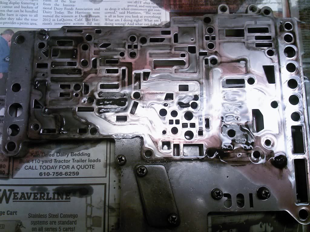

I recomend Dexron II/III or ford type "F" for older non lock-up transmissions. I'm not very fond of ATF+ fluids for older high mileage trans. The high detergents can loosen sediment collecting in the valve body.

I was reffering to sediment that's fine enough to pass through the filter,but settle in the valve body,like this:
This VB came from Rick covalt's blue car. It was working fine,but he removed it so I could perform my own shift kit mods.

I see that same sediment in every trans I have ever opened up, regardless of make, model, or fluid being used.
