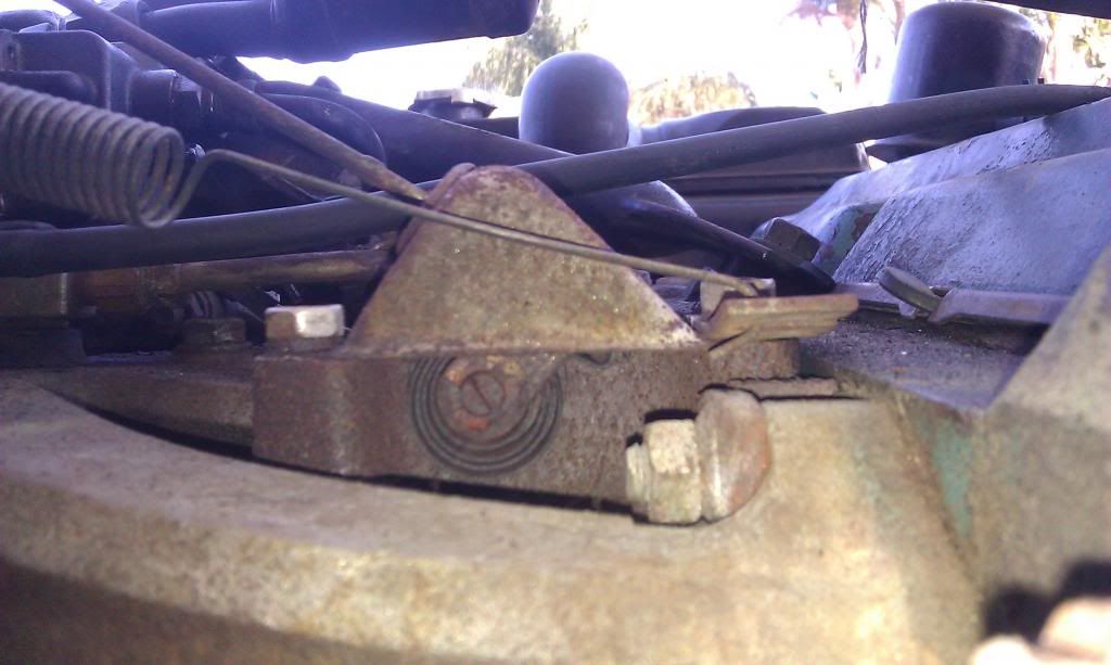

Duster - That would be awesome if you have a manifold from this year hanging around. I checked out my choke pocket today and I think I have the fully open choke. See pic below
u
Let me know if you have one available. Just curious, how urgent is it to fix a cracked manifold?

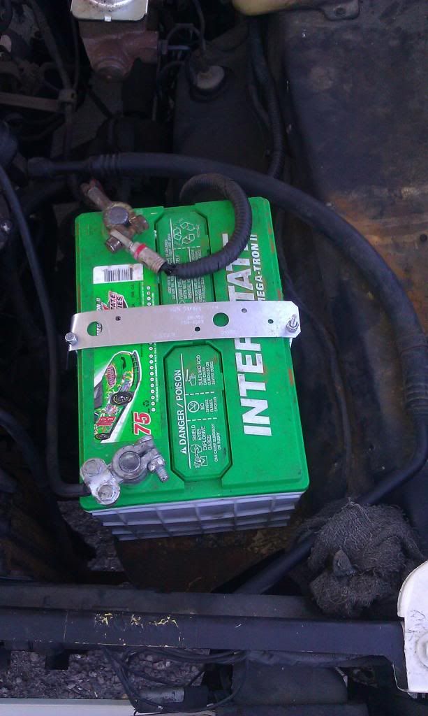

Today I added a battery tie down. It's not perfect looking but functional.
One thing at a time.

Well I have one with the open pocket left, and as you can see the bolts and stud are all broken off (oddly the choke flap is free and clear and all intact.)
So no go there.
I have a 1967 valiant circuit board that still has the factory blue film covering the copper traces, if you should find that your gauges are not working because the board has corroded.

If you are going to order a new one, I'm sure they will be like the later versions with the closed choke pocket. I do know I have a couple of those in much better and useable shape.
The problem there will be the choke thermostat and pull off...you would need the full electric conversion choke in any case, or if a Holley 1920 carb the now discontinued pull off for a 1973 225 slant six Valiant...

What, if any, modifications need to be done to make a manifold with a closed choke pocket work my current set up?
You would have to get a late choke pull off, yours will not work (I might have a used one that's intact laying around as well.
-D.Idiot

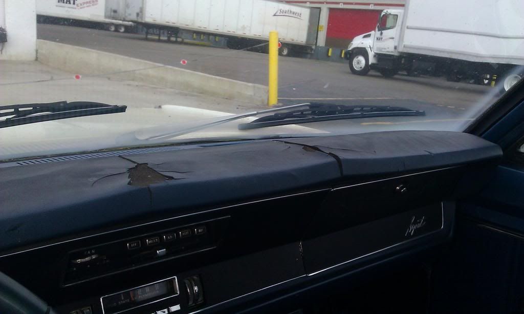

Thinking of getting a dash cap asap but am unsure if it will work given my dash's condition. I would cut off the ridged areas and sand it down a bit. Would probably have to be black to avoid getting some off blue that doesn't match the rest of my car.
Anyone done the cap before?

my dash is cracked in the same places

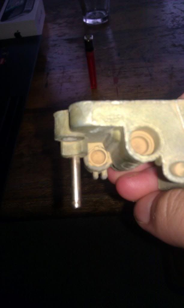

Hey All,
Attempting my first rebuild. Got everything apart and snapped my fuel line, solved that problem though. My new issue is the "Economizer"...My kit came with a new ball for it but I have no idea how to get the old one out (or if I need to). Also, the gaskets/brass rings that hold the other two balls in are pretty loose and I do not have replacements.
Any ideas how to get the main ball out? Are the brass rings for the other 2 suppose to be moveable?
