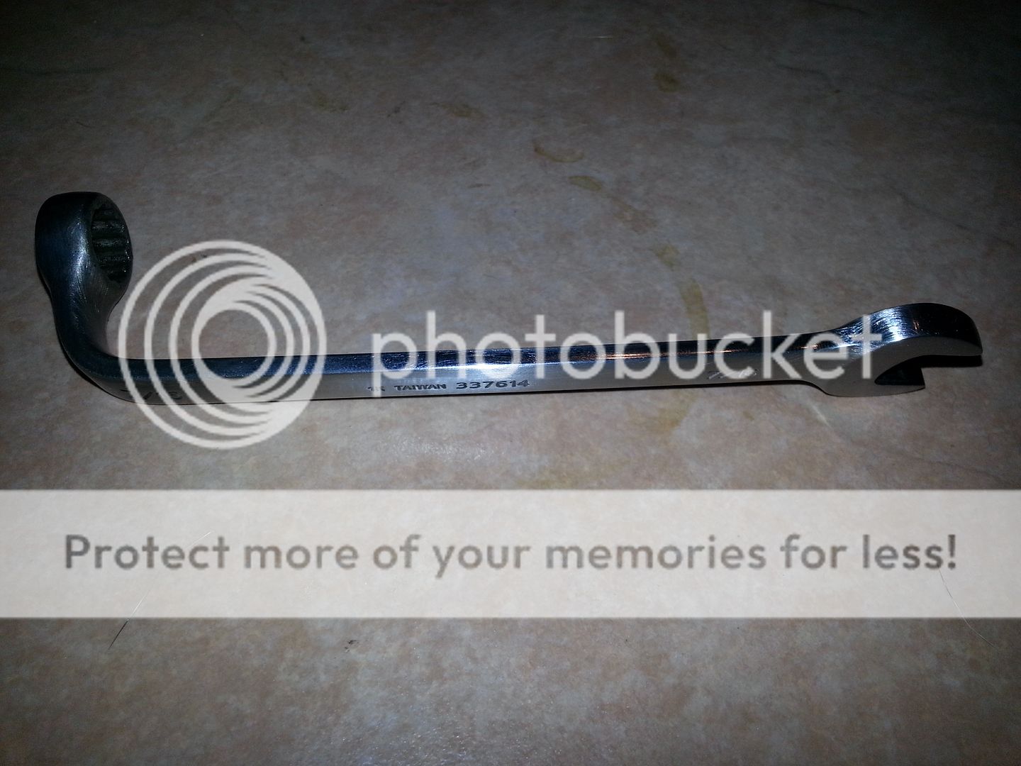

I looked around and could not find a 7/16 distributor wrench I was willing to buy. So I went to lowes and bought a "long" handle wrench for 6.50 then proceeded to bend it. Nice thing about the Kobalt brand is they have a line indicating SAE vs Metric that line is PERFECT for heating to bend at.

Lol give it time. I did find my least favorite thing about using it. Burning my hand on the head. Damn thing gets HOT.

I drilled a hole in the handle of a cheap wrench and welded a peice of round shafting in the hole then welded a short peice of the rod onto the end to form a T shaped wrench.

I have these in 7/16, 1/2 and 9/16
http://www.mactools.com/Product/tabid/1 ... fault.aspx

Yeah MiDi I just have a problem paying 50+ bucks for a tool that gets used VERY rarely.

have bent,ground several wrenches for special use

The one Rob recommended long ago is still available for $14ish...
See: http://www.toolsource.com/distributor-w ... 51101.html
