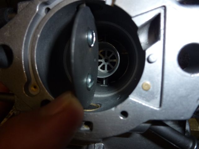

code is 7587, not 7586 as depicted on our beloved internet :x
and the throttle shaft has slop, brand is Vapex
two questions
is this the Economaster I want?
how much slop is acceptable in the throttle shaft? I never get an answer
my Holley EFI on my Jeep has ZERO play

Well I was angry because the number didn't match. I went and measured and the slop is 2-3 hundreths of an inch. Enough to move the shaft back and forth laterally and see a gap. Same gap on both sides.
Now I'm a bit calmer. SSDan says 7587 is '73 Economaster. Researching the slop tolerance on the net now and not coming up with much.

Sean,
You can tell an Economaster in a millisecond, by looking down the throat.....
Does it have a wagon wheel venturi? or does it look like a Hamm radio antenna? Mine part number is 7585.....
On the shaft......mine had a fair amount of slop even when it was brand new!
Don't worry about it.....it idles perfectly at 2 turns out and the engine pull 19" of vacuum at idle, never missing a beat at 600 rpm in gear for hours in traffic.

Hi Ted
It's the wagon wheel!
and this one has EGR (not as excited about that, but what the hay)
The base gasket is different from the 1945. Does it even matter?
