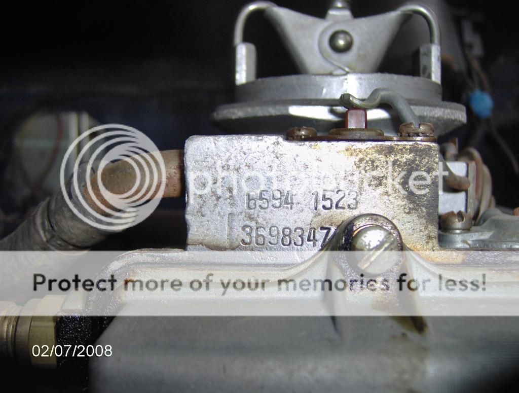

http://www.auctiva.com/hostedimages/showimage.aspx?gid=1618572&image=579174654&images=579174654,579174704,579174764,579174817,579174877&formats=0,0,0,0,0&format=0 In the middle of picture ,that small dark hole is adjustable idle air bleed.If you have that it would be helpful to get it freed up. What is your carb no? That hole is just behind and near top of fuel bowl.
I notice the carb is loose, it also has a real thin gasket between it and the manifold. I also notice there is no choke hooked up.
I am pretty sure its not original to the truck but hopefully these numbers will give a clue to what it was made to work on.

I found a 12R 5592-B That sounds more like the # Thanks
EDIT: Ok according to this thread that is not the correct number but I dont see any other #s
EDIT: http://www.slantsix.org/forum/viewtopic ... 7298c65688
No listing on mikes carb site, just my luck I get a one of a kind carb :(

I did not know about Mike's back when I ordered my kit from Oreilly's or I would have ordered from Mike's.
Here is the link to the kit for that carb on mikes site http://www.carburetor-parts.com/Holley- ... p_661.html
Look at aplication list. third row of carb numbers yours is listed there.

3698347 is the mopar part number for your carb and will determine the year and settings for it if you had the factory parts catalog and manuals for it...since it has a bowl vent it most likely is in the 1971-1973 range depending on emissions package or the standard bowl vent in 1973.
Yes, I stand corrected again in that it looks like the correct/possibly original carb for the truck. Thanks
