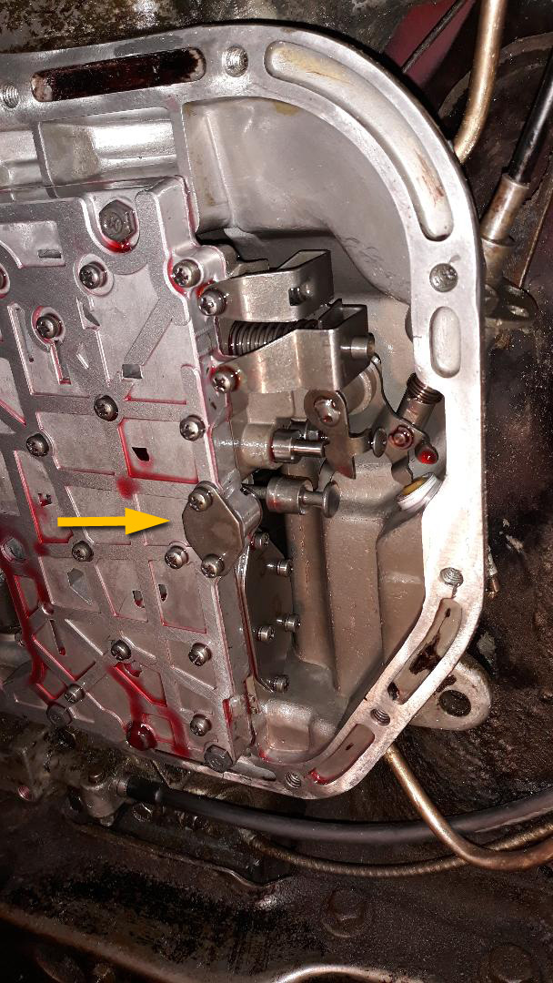

I had the Vert's transmission apart recently and I got a picture of the valve body and the part I believe is probably causing these transmissions to refuse to go into reverse.
The arrow is pointing to the bottom cover of a part that slides up under pressure and keeps the transmission from shifting into reverse when the vehicle is in motion. When a certain speed is attained, this piece rises up through a pair of slots in the valve body and interferes with the travel of the shift selector valve, thus locking out reverse.
If this piece were to get stuck in place when hot, it would cause the transmission shift mechanism to bind and refuse to go into reverse. In my 65, it would bind up, but I could still get it to go into park because the park lock is a separate cable.
Thoroughly cleaning the valve body might cure the problem.

Interesting. I'm not sure this would explain my transmission's failure to go into neutral as well, but I'll check it out.
