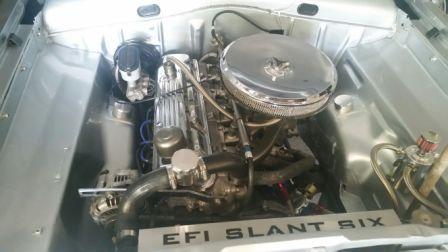

Hi Greg. I run a pro bullet highball coil. Ebay purchase , have 1966 valiant ms2 hei8 module port injection. Have had no trouble yet...
Cheers . Rob

here is a pic
