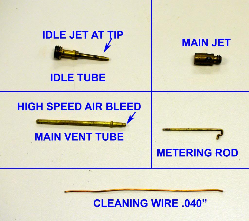

PostPosted: Fri Jul 20, 2018 5:45 am
Posts: 1603

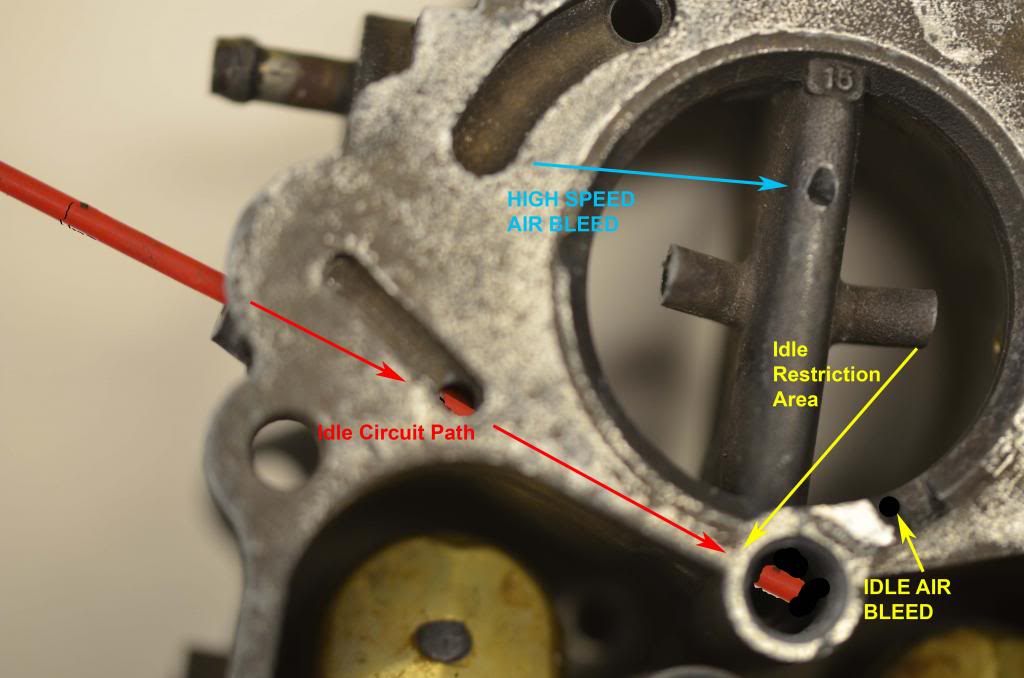

PostPosted: Fri Jul 20, 2018 6:00 am
Posts: 1603
PostPosted: Fri Jul 20, 2018 6:16 am
Posts: 1603
PostPosted: Fri Jul 20, 2018 6:29 am
Posts: 1603
That blue line is top of main vent tube,a little small amount heat, pb blaster,let soak. Flat punch, light taps,should fall out bottom.
