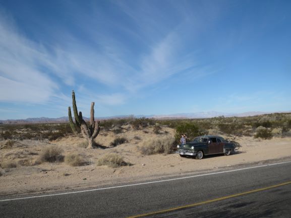

Hers a pic Andy!
In Preparation for our annual trip south I have done some EFI tuning with mileage in mind.
I chose the same 22 mile run...in both directions. I tried to stay on the target speed.
The route has some climbs and twistys.
Results:
50 MPH> 24.5 MPG
60 MPH> 23 MPG
70 MPH> 21 MPG
80 MPH> 19 MPG
An all-out 60 mile dash (Ferry to Revelstoke and return) some 100 MPH dashes,,,,lots of grades and passing. 17MPG.
4500lb car.....16 second ETs... 240hp

Very nice results, Sandy. Thanks for measuring and sharing! The aero can't be too terrible if you getting those numbers. Did you ever do a similar test with your Buick wagon?

Good thing you have the bike rack installed for your personal mpg trials :-)

Lou: I am getting slightly better mileage than the LT1 Buick wagons. Im happy enough with my aero considering the Buicks have a CD of .33. I suspect my DeSoto frontal area is smaller.
My aero work consists of an airdam and partial bellypan under the front bumper,,,,a partial grille blockoff and closing all redundant openings in the front of the car. The rear has a partial diffuser under the rear bumper.
All aero work diminished wind noise and improved mileage.
No bike rack for mileage tests.
