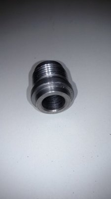

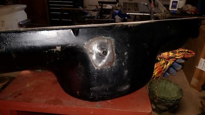

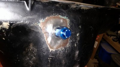

Got to try out my new step drill.
Found a good weld on fitting, the step fit tight in the hole and made welding set up easy.[attachment=0]

PostPosted: Tue Nov 13, 2018 5:09 am
Posts: 17549
Cool fitting.

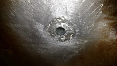

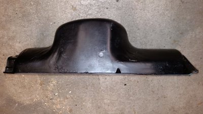

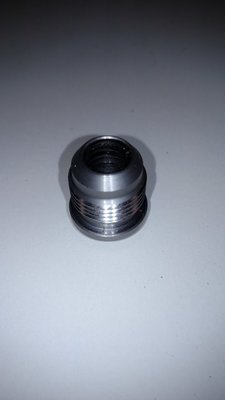

PostPosted: Thu Nov 15, 2018 4:04 pm
Joined: Sat Jul 26, 2003 8:09 pm
Posts: 380
Location: Connecticut
Car Model: 62 Lancer GT
Yes worked out good. Fit tight I dont even think Ill weld the outside. Maybe some JB weld.

PostPosted: Thu Nov 15, 2018 4:22 pm
Posts: 380
It was cheap to, $8.99 for 2 with free shipping. Tried to get it near the main but ended up at the counterweight. .....

PostPosted: Fri Nov 16, 2018 2:06 pm
Posts: 17549
Please post the fitting source/link/part number when you get a chance.
The oil just dribbles out so I would not (and did not) worry about location near counterweight or whatever else.
