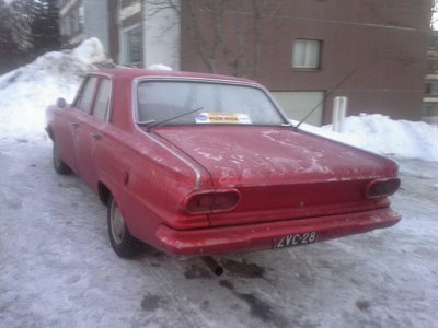

I got this 1965 Dodge Dart, with 225 /6 and 3-speed manual, just couple of weeks ago. It has some running problems, everything is out of adjustment or adjusted wrong/out of spec. I actually got it running better just today, now it's more driveable, still not perfect though. It is a bit ugly, it has some rust spots here and there and the clear coat is in quite bad condition.
Also the interior is in pretty rough condition and there is no sound proofing or trim in the roof. First thing is to instal some sound proof in to it so it is quieter to drive, especially in rainy weather.
Last friday it already broke down so that I couldn't engage the first gear or reverse. It was because the clutch wasn't disengaging properly. I had to take the transmission out and inspect the clutch. It turned out to be broken stop pins/rivets and because of that there were some parts misplaced in the clutch disc. It was still possible to hammer the rivets like they were supposed to be, so I did that and installed all back together...works with no problems.

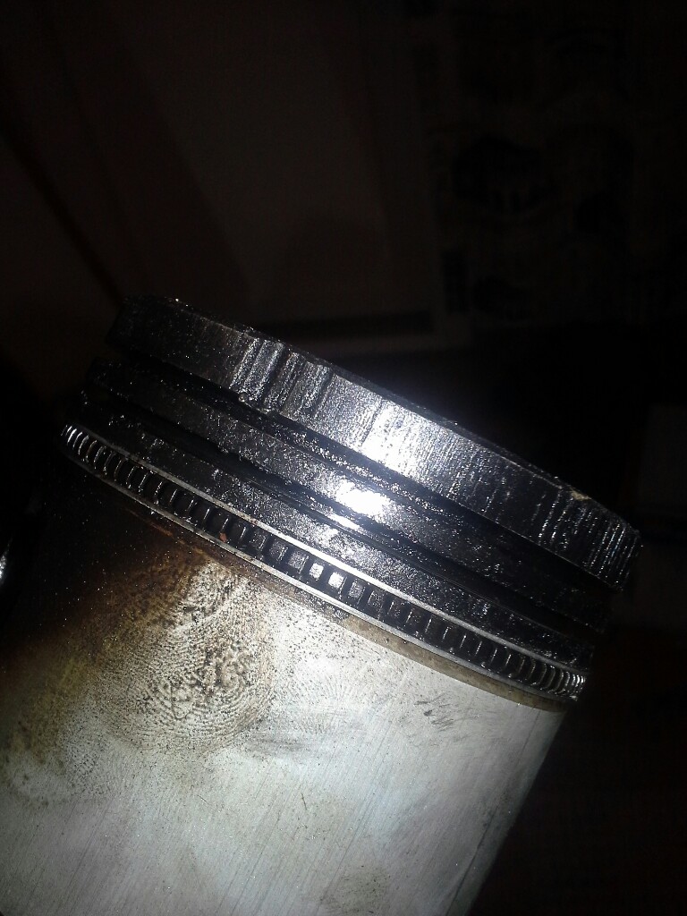

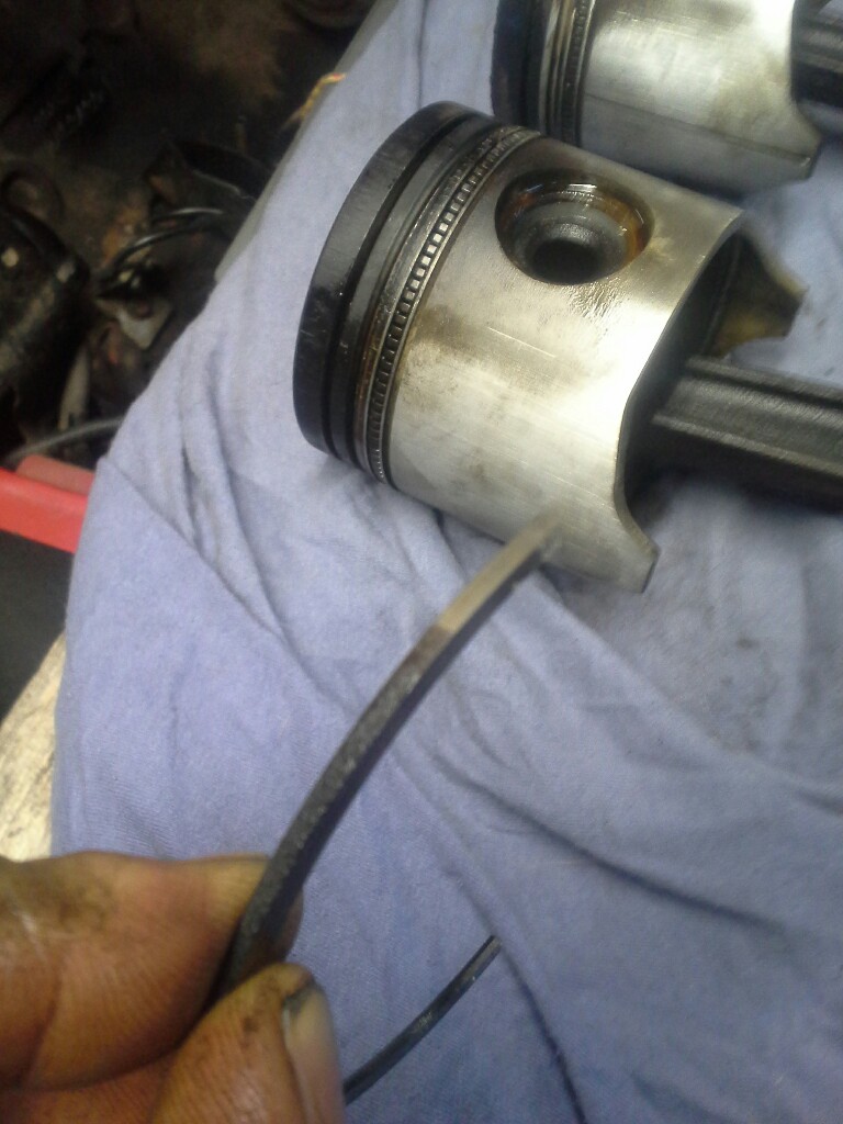

The problem is several broken piston rings. There was broken rings in the cylinders that had a good compression too, I didn't know that only one compression ring seals that good. You might wonder that maybe those rings broke when I removed the pistons but it is clearly visible that they have been broken for a while based on the wear they have. Thankfully the cylinders are fine and only one piston has some damage.

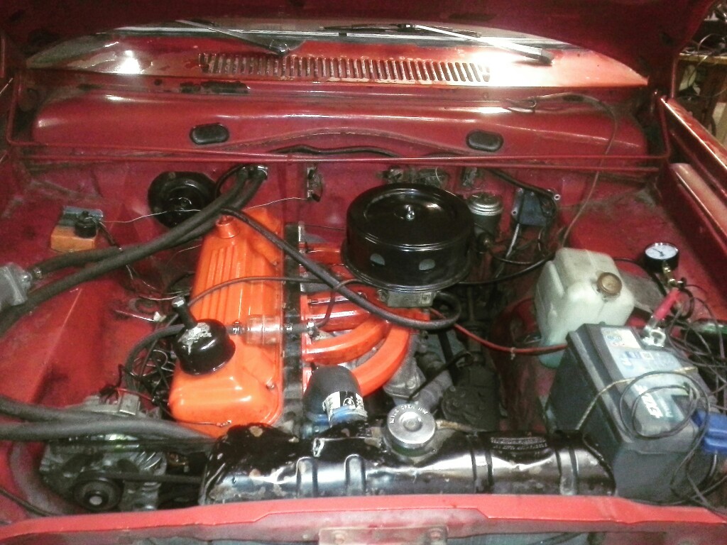

The engine in my Dart is now fixed and I have driven about 200 miles since then, so far everything is great (*knocks on wood*). Here are couple of pics.

Cylinders are now honed and the first piston is installed with new piston rings. I ended up reusing the old pistons which might raise some questions but I have to do this as cheap as possible. The car will never see any hard driving anyway. The piston ring grooves on the pistons were still in spec when I measured the clearances with new rings.
If I had known sooner I would have given you a set of low mileage stock pistons with good rings. Those look pretty scuffed.
PostPosted: Mon Mar 25, 2019 12:40 pm
Joined: Mon Feb 11, 2019 9:15 am
Posts: 53
Car Model: 1965 Dodge Dart, 225 Slant Six
They would've had to been .060 oversize pistons. It'll work great as a cruiser that it is. I managed to take every sharp edge off of it and it actually wasn't as bad as it seems in the pic after I ran them in the parts washer. It was #6 piston that had the damage, rest of the were fine. Thanks anyway!
