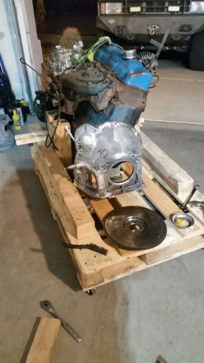

I think I am using "engine" and "crank" interchangeably". The holes line up just fine, but I will need some longer bolts. Why do I need the bell housing on the motor to test the engine? I just want to run it for maybe one minute on my stand to ensure there isn't anything catastrophically wrong with it. I need to order a starter and some spark plugs, then should be good to go.

PostPosted: Tue Dec 24, 2019 1:12 pm
how do you plan to mount the starter?
order a starter
if you are going the OE large style starter I bet that I have one around here
that I will send to you for the price of shipping.
if you are going with a mini starter, get one for $15.00 from a local pull a part
PostPosted: Tue Dec 24, 2019 1:51 pm
x2, and how about securing the rear of the engine so it doesn't wobble and tear up your
Fir motor mounts.
ARP 240-2801, use loctite on install...
You will eventually need the clutch cover bolts...ARP 150-2201 when you install your clutch during assembly for installation.
x2 on Junkyard 1992-1996 Dodge Dakota Starter for 5.2L V-8
1978 Cast Crank Engine with peanut plugs, NGK-UR-5 or if going cheap AC Delco R-45TS, gap to .035

Dadtruck: it looks like the starter is supposed to mount onto the engine with the teeth covered by the bellhousing. I need to get that service manual. That said, I'd be grateful to take you up on your offer unless there is a reason why the other starter would be benificial. How can I send you money for shipping?
Dusteridiot: I'll have you know that's the highest quality structural pine that my compay can get for the cheapest price. But yes, I will take your advice and find some way to strap it down. It was minorly terrifying levering it off the engine hoist with a pipe while trying not to drop the whole thing 4 inches. Next, looks like the NKG plugs are only 2ish dollars. Do more expensive plugs really make a difference? Finally, why should I go with those bolts vs going to ACE hardware? Better temper?

Dusteridiot: so the 1992-1996 Dodge Dakota Starter for 5.2L V-8 will fit the slant 6? There are a number of yards near me and I don't think there will be a major issue finding that part. Finally, would like to clear up that part about the bolts. I would prefer not to injure myself or damage the engine. Ironically, my job is safety focused.

NGK plugs are fine plugs. No need for "exotics". If this is just a temporary stand than you can use some Grade 8 bolts and washers from the hardware store. But these flywheel bolts are known to come loose, so you will want to get the correct factory bolts or the ARP bolts mentioned above and use locktite on them for a permanent install.

Most of us here are of a certain age and experience. I would hazard that most of us know the cursory difference between Grade 2, Grade 5 and Grade 8 bolts. All of those grades of bolt may be found at the corner hardware store. Only one of those grades may be suitable and only if chosen with knowledge and care, the other grades are not suitable. Not that you're likely to find a Grade 2, 7/16-20 bolts, but if you did and they were installed you could quite possibly have the flywheel come off the engine at speed and experience catastrophe. Some of us don't want to be involved no matter how peripherally. The ARP parts given are suitable without question.

Adding to what Joshie225 said, any engine will have many "critical" fasteners that are special for the specific application. The flywheel bolts are a great example. Not only are they very high strength but they have precisely sized base diameter that fits very snug in the flywheel holes. Even a high quality, high strength but 'generic' bolt is not appropriate here. It not only has to hold the flywheel to the crankshaft it also has to locate it precisely enough that it can't shift on the crank or wobble around. A lot of force goes through those little bolts. If the flywheel moves relative to the crank bad things happen quickly.
Similar requirements apply to head bolts, rod bolts, rocker shaft bolts, etc.
