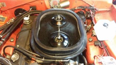

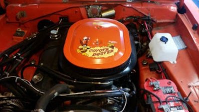

Do this air cleaner mod, this looks great. IMO
