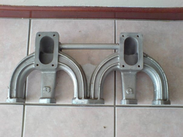

Dividing an I-6 into 2 cylinder groups 1-2-3 and 4-5-6, especially an engine with a long duration cam, should considerably increase torque at all speeds except at the top of the RPM range. The reason being is that the intake strokes will not overlap and compete with one another. It probably won't quite match the throttle-per-cylinder setups for torque, but I'd bet it gets quite close. This makes the medium-long-runner South African intake manifold with 2 progressive 2 bbl carbs quite attractive. The next best bet may be a Hyper-Pak intake divided into 2 plenums. I do believe Doug Dutra tried this, but I've not spoken with him about it. The extra torque would make street driving more fun and allow use of a lower stall torque converter. Richard/Fopar in fact gets away with running a stock torque converter in his dragster with the six-motorcycle-carb intake.

As for unusual intake/carb setups, here are pics of a twin-carb dual-plane Slant Six intake from South Africa (with photobomb by an orange-painted twin-Weber intake also from South Africa).
I love those. I tried to track down 68barracuda after finding threads like this one scattered through a few forums, but I had no luck. I wonder what became of the recasting projects.

Aluminum 3D printing exists, but it's very expensive. The orange South African manifold would get you probably 90-95% of the way to what I hoped to achieve.
