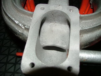

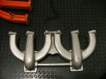

Posts: 25051
looking for photos of "parallel" 1bbl-to-2bbl intake mods
See the parallel 2bbl setup article. Photo documentation of a very well done such conversion is here.
That single Dell'Orto modification to the stock intake is nifty but appears to be faulty. The carb mounting pad is not supposed to be parallel to the top surface of the intake manifold plenum!
As for unusual intake/carb setups, here are pics of a twin-carb dual-plane Slant Six intake from South Africa (with photobomb by an orange-painted twin-Weber intake also from South Africa).
I love those. I tried to track down 68barracuda after finding threads like this one scattered through a few forums, but I had no luck. I wonder what became of the recasting projects.

Aluminum 3D printing exists, but it's very expensive. The orange South African manifold would get you probably 90-95% of the way to what I hoped to achieve.
My one-off manifold was being fabricated from mild steel. Not as sexy as aluminum, but I can weld steel with the equipment I already own. I bought aluminized exhaust tubing for the plenum and runners. I made the tapered runners and the air horns to fit inside the plenum. The air horns would need to be changed for use with carburetors. I started on the head flange and it's under the bench. The next step is to make a mandrel to form the round tube runners into the intake port shape.
