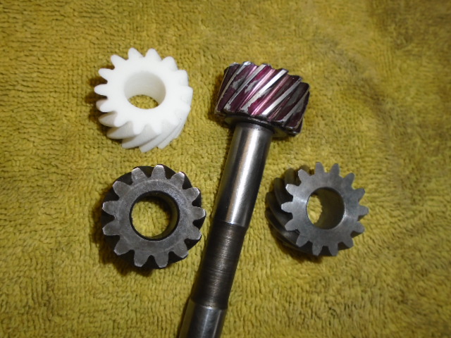

The photo below tells a story about the oil pump gears shown.
Any guesses on what that story is?

H'mmmm. Is 3D printing involved in this story?
 Post subject: Re: Oil Pump Gear Work
PostPosted: Sun Aug 16, 2020 4:05 pm
Posts: 3740
Location: Sonoma, Calif.
Yes, the white gear shown was 3D "printed".
Please excuse my ignorance here: I've heard of 3D printing, But have no idea what that white gear is made out of.. and or how such printing is done in a way that ends up with a steel gear being ready for it's intended use.

The plastic gear was "step #2,
We designed a new SL6 oil pump gear and proto-typed it with a 3D printed gear.(stereolithography)
The material used is soft, much like ABS plastic so it was not intended as a final product, just to prove the new design.
Truth is that the SLA gear was way too soft, It was impossible to really get good gear contact & load info. off t so we took the cnc file and machined another gear, out of aluminum. (thanks Wayno) :wink:
All this led to a small lot of pre-production gears... machined at a gear shop.

I picked up 2 NOS /6 oil pump gears off of feebay recently. The old blue and black MOPAR packaging.
It is nice to find / use the original Chrysler produced oil pump gears. Those seem to have less failures.
Truth is, we still see oil pump gear failures, especially in high RPM / performance Slant engines..
I have personally tried many things to fix this issue but it still "bites" me (and others) every so-often.
This new gear design is the latest effort to prevent failures.
So what is different with this new gear design? :?
