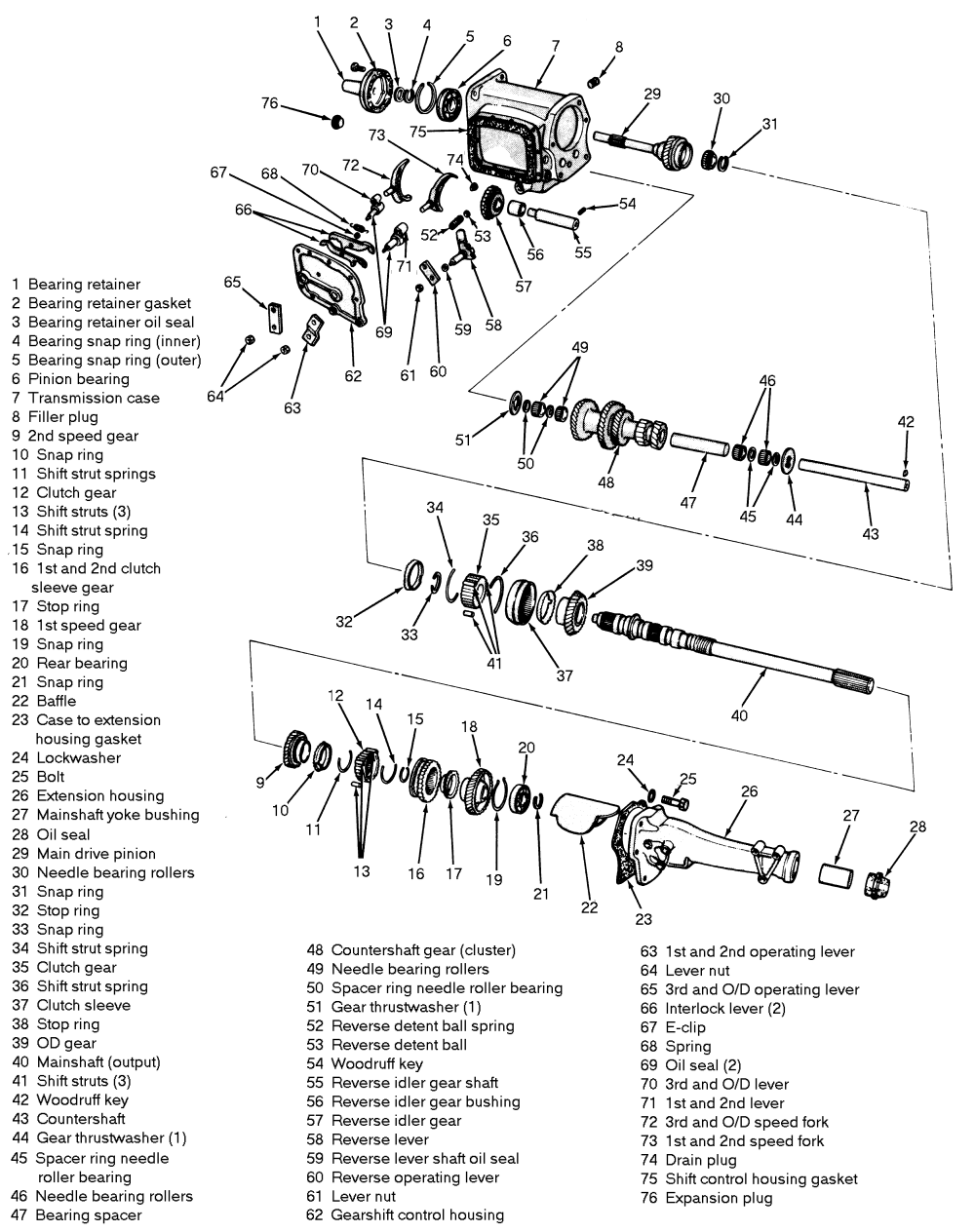

As for adding a syncro to the reverse in a A230 3 speed, the reverse gear must have the syncro angle machined onto it. ( that area currently has a square shoulder)
The 1st / Reverse slider hub needs some machining to allow room for the new (added) syncro ring. If memory is correct, a 833 four speed 1st / 2nd slider hub will swaps-in and does the job.
Take the reverse gear, along with your 1st gear and the syncro ring, to a local machine shop and see if they can machine the angle. Have them match what is on the 1st gear.

Just replace it with the 833 unit...
But there are a few different 833 slider hubs (clutch gear, in the FSM) with different "shift struts" sizes so look at the ones you have and match that... it is most likely the later "wide strut" type.

So, I went to the shed and pulled-out the related 230 parts. ( I can't believe I save all this stuff) :roll: :roll:
I also pulled-out the 1st/2nd clutch hub (later wide shift strut type)
Note the unmachined syncro area on the reverse gear. Also see the different shift strut clutch hubs. (the outer slider ring is also different for each strut type)
My goal here is to re-do what I did 35 years ago...
Step one, machine the reverse gear to accept the sycro ring. ( lathe work)
Getting the angle right is a little tricky but measuring and some "math" gets it.
A good amount of hard steel comes off this area so don't tell... I used my angle grinder to rough-off most of the metal and finished-up with the insert cutter.
Before and after:
I put the machined reverse gear onto the shaft, with all the mating parts and saw that the shoulder on the 833 clutch hub interfered with the ID of the 230 reverse gear.
Unlike the 230 clutch hub, the amount of interference was about .006... not a lot but enough to prevent the reverse gear from fully seating into the hub.
So I polished-out the ID of the reverse gear with the hope that this would do the trick.
Still a little interference so I stuck the hub into the lathe and took a light cut on it's inner hub... that did the trick.
( from memory, the 230 hub has more material that needs to be removed from this area)
And now all fits together like factory design... with the extra reverse syncro ring added!

I want to stay with the A230 because the 1st/rev is on the same shift rod. I am using this setu in a forklift and 99% of the time I’m going from 1st to reverse. That’s why I want to put a syncro on reverse. So can I just get the 1st/2nd slider from an A833 and replace my 1st/rev slider?
So the direct answer is No.
You still need to do some minor clearance work to the 833 clutch hub so the 230 reverse gear fits into it completely. (see post above)
