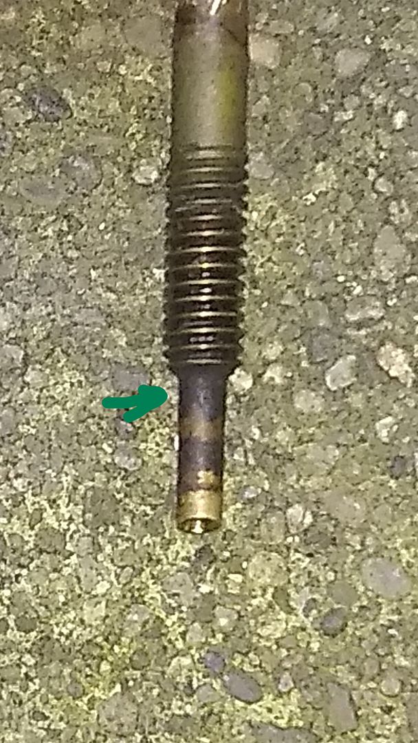

Manifold vacuum input to amplifier won't hold vacuum. So hidden vacuum leak into number 6 manifold runner. Thats good diagnostic work. The egr Venturi vacuum port restriction in carburetor is quite small .031 in the one measured. Reverse Flushing, vacuum tube over red straw and Brass port, well either clean them out or verify that they are indeed blocked. The tube can be removed they are threaded ,place a small drill bit 5/64 or number 47 bit .078, into tube to keep small pliers from crushing tube. Screws out really easy.

Green dot is location of restriction.
