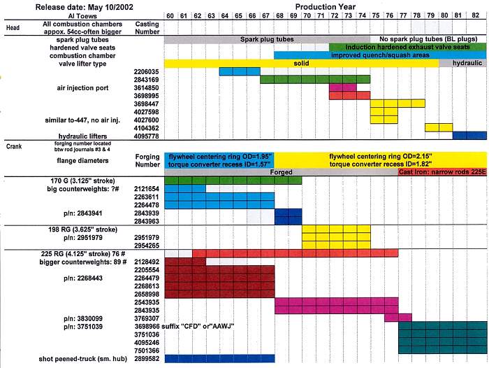

IIRC, the small pilot hole is 1.6xx" and the big one is 1.8xx.
PostPosted: Sun Nov 01, 2020 9:41 pm
1.57" is the small hole, 1.82" is the large hole according to the parts matrix. https://www.slantsix.org/articles/parts ... ix-pg1.jpg
OK!
This finally seems to put a positive ID on this engine.
The first set of photos with the ruler were no good....the caliper makes interpreting the measurement much easier. Thanks to everyone here pointing me the the right direction of what to measure!
