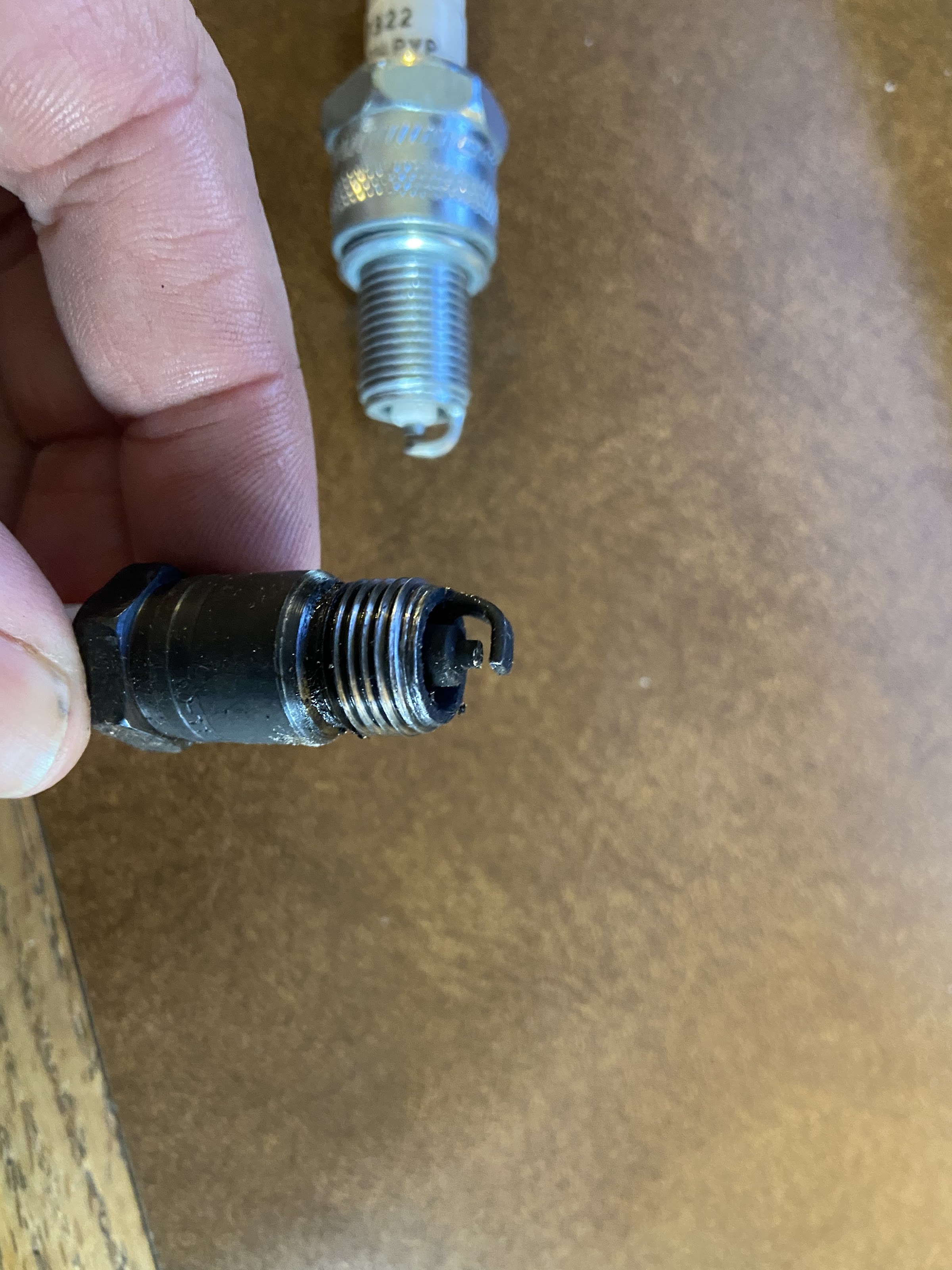

We also checked the plugs. They were all very black. No signs of oil. However, when I looked up the part number (Autolite 25), these did not appear to be the correct size for this engine. We bought some Champion 7322's.

  6. We did a compression test. From cyl#1 to cyl #6, we got 165, 165, 170, 170, 160, 145. I'm a bit concerned over cyl#6, but we'll let it go until we can adjust the valves. That new starter and battery seem to be going strong.
  7. The plug tubes were removed and the old tube gaskets were pulled and trashed. New gaskets were installed.
  8. New Champion double platinum #7322 plugs were installed, with a dab of anti-seize on the threads. I read in Doug Dutra's Chrysler Slant Six Engines Workbench book to remove the metal ring gasket on the plugs, but I left them on. This was the first time that I've heard of taking the rings off. Any other thoughts on the matter?
