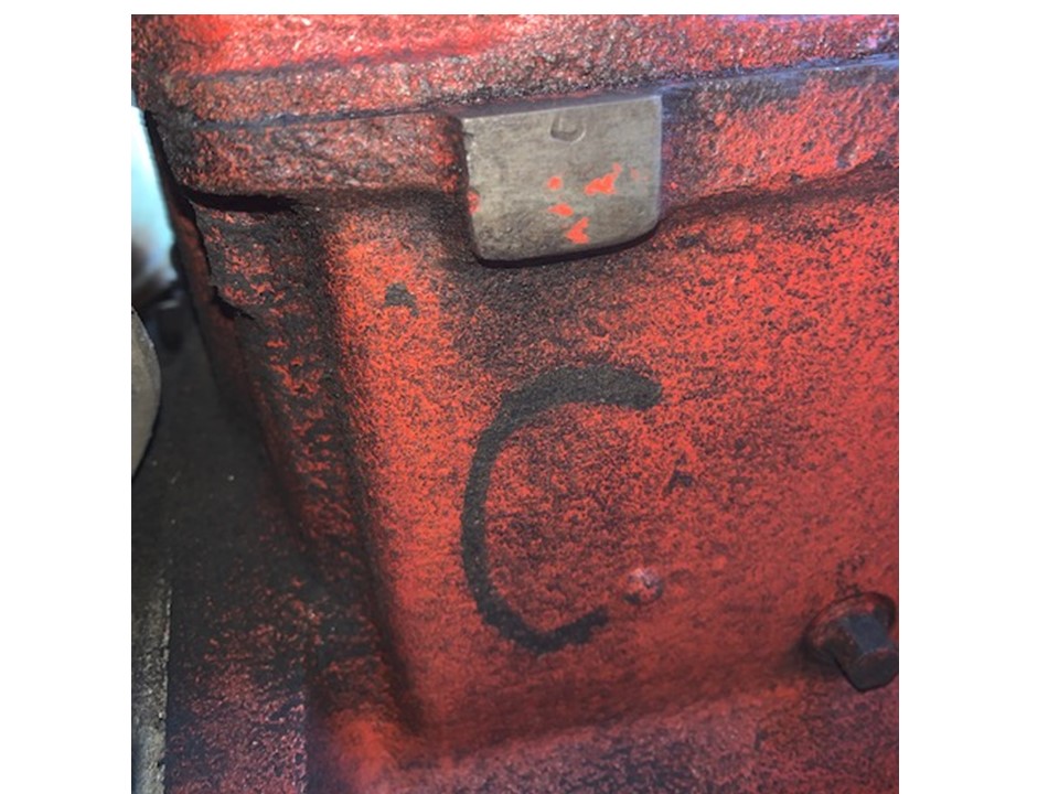

There is a pad there but it has nothing stamped on it. (Blank)

Photos

There should also be a flat surface on the block just above where the oil pan mounts on the passenger side. This would be a long narrow flat spot with the last part of your VIN stamped into it. The pad in your last picture is not it.

I don't think they started that til 69 or 70 model year
