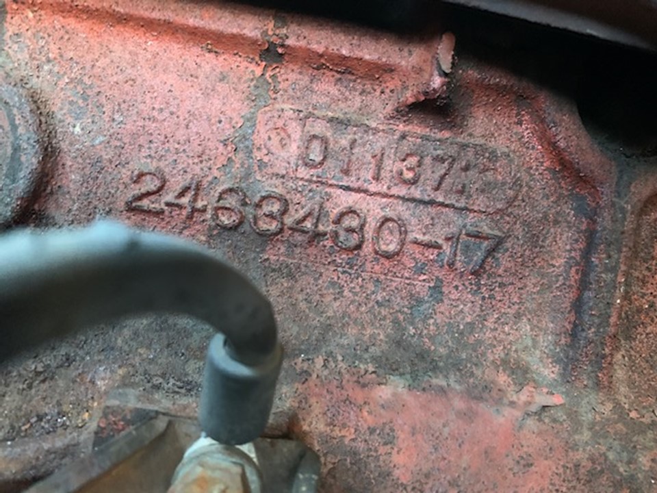

I am here because other forums would have great fun with this question as my car is a 1968 Satellite with a slant 6. My question relates to casting numbers, casting dates as well as stampings. My 1968 Satellite slant six has a casting number of 2463430-17 which seems to be a 1966 225ci RG 6-Cylinder Engine. My casting date is 01137 or January 13, 1967. However, the block stamping behind the coil is PT225 R 22680792 which I believe decodes as follows:

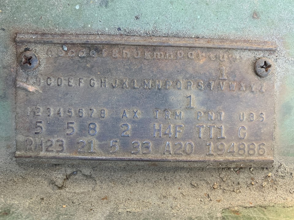

Now for the kicker, my build date on my Body Plate is A20 or October 20, 1967. It seems like the block stamping lines up with the build date of the Satellite but as you can see, the casting number and casting date do not. Also, I do not see a vin stamp, or anything else (blank) on the block pad near the firewall.

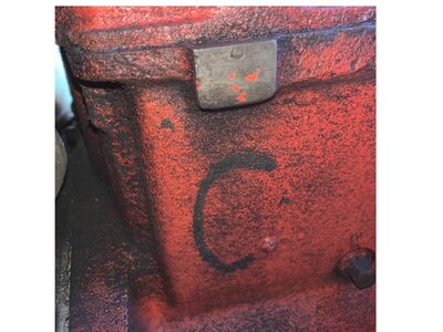

There is a pad there but it has nothing stamped on it. (Blank)

Photos

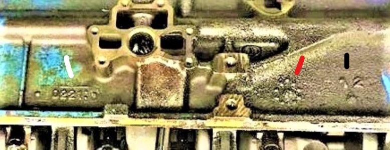

Image if it's there it should look something like this
PostPosted: Tue Feb 23, 2021 1:11 pm
Posts: 1603
Image could be wrong on this but I always thought the actual casting of the block indicated by those white date code red clock or batch number and black shift number
