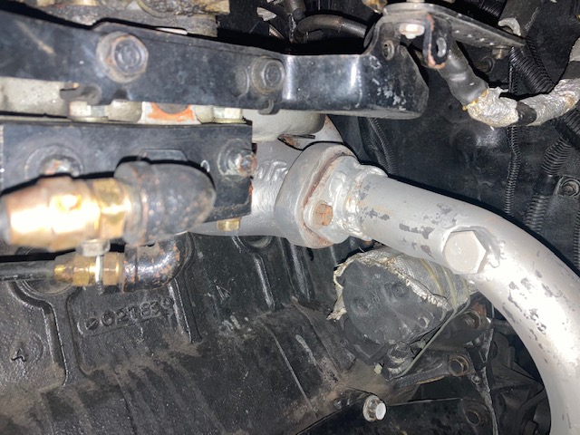

as mentioned photos of a rear Dutra Exhaust,, these are vintage 2010 parts, way before AussieSpeed took over production.
the front and rear castings are the exact same parts, machining changes to a drilled pilot hole and spot face change allow the casting to fit in either position. The issue is the rear manifold flange is tilted to allow minimal clearance to the starter. That situation is workable with a mini starter on a 225.
I believe that AussieSpeed modified the pattern to produce a rear manifold that improves the clearance to the mini starter.
File comment: clearance of an original / pre AussieSpeed Dutra to a mini starter.
