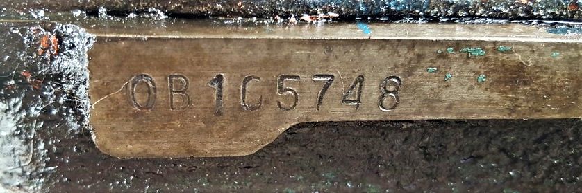

Author:  matv91 [ Tue Feb 23, 2021 11:00 am ]
Post subject:  Re: Help on my slant six block authencicity
Image if it's there it should look something like this
