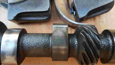

Camshafts seem to be the biggest difference in the use of an engine. I measured my 68-74 engine with a 72-73 head and its cam lobes. I am not sure where this engine came from on my boat. The lobe height is 0.26 for both intake and exhaust.
This doesn't seem right. Very, very conservative. The lobes are very peaked with steep ramp up and down. Both looking the same contour. No wear to speak of that I can see.
Is this maybe correct? Or is there something better for my application?

Stock SL6 cams were different over the years and used different lifts that were in the .365 to .415 range.
Example: Lift for the 170 intake is shown as .375. and early 225 was .395
170 exhaust lift is listed at .365 and the 225 at .395.
By 1965 the service manual lists both 170 and 225 intake lift as .375
The later '71-'80 cam has the most lift at .414 (244° duration intake and exhaust)
You may want to custom grind a cam for you marine engine and use a cam design that makes max torque in the boat's primary operation RPM range.

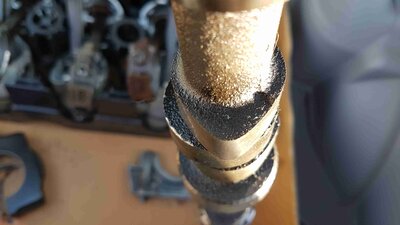

I don't know the timing and duration of this cam, so at this point I can only go by lobe height. The lobe height I have is either severely warn down, or it is ground to that low a height for a reason.
What effect does the lobe height of only 0.26 have on this engine. I know it only opens the valve so far, and only about 2/3 that of a street cam. But does that increase torque some how?
I have attached a couple of photos. It doesn't look that worn out does it? What about how the geometry of the lobe? How does that compare to other cams people see for their slant 6 for street use. The lifters do not have any concave to them, but I guess they could have been replaced when the head was off by previous owner.

I've heard among many engines that "marine grind" vs "car grind" doesn't really mean much except for those that rotate opposite normal. I'd send it to either Oregon cams or (maybe) Delta Cams (I don't know much about Delta besides that they exist)
You're not gonna get much out of Comp especially since it isn't a damn Chevy..... Nowadays it has to be a damn LS to get their attention (where is the middle finger icon?)

The D’s have it. Don and Doc are right on track.

DusterIdiot, thank you for clarifying. I didn't think of rocker involvement. That makes sense now. The cam didn't look at all worn down by nearly 3/16".
