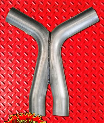

OK, so I have been working on getting my exhaust connected to the Clifford shortie headers. My intention is to combine the two separate header tubes into one pipe and then have a full exhaust (muffler and tailpipe) with a cutout for uncapping to race. I am considering two options right off of the headers. The first one is a 2-1 merge pipe with a cut-out (Y pipe) right after the merge. The 'straight outlet would be cut a little shorter than the pic and get a 90* turnout that can be capped off. The 'angled' tube will go over to the rest of the muffler/exhaust.
The merge pipe is basically positioned right next to the (automatic) transmission. The problem here is that the cut-out pipe (straight section) is then very close to the crossmember that the trans mount bolts to.

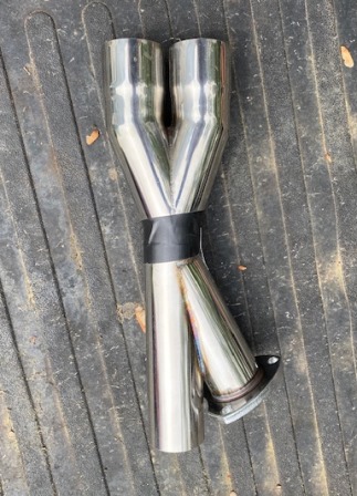

I found an X-pipe that I think can be a better fit.
I would cut it down some to fit, with the angled parts one leading to the full exhaust and the other would be for the cutout.

I guess my main question is whether the merge between the two header sets is considered a collector and whether the shape is of any importance. If nothing else, I am going with the second setup as it will greatly simplify getting my exhaust configured.

I would really consider putting the cutout 12-24" behind the Y-pipe, and/or moving the Y-pipe back just behind the trans X-member. You will generally make more power with the Y-pipe junction at or just behind the X-member, then I would put the cutout Y about 6-18" behind that. There are not huge gains to be had here, but a few HP and easier access/packaging would be 2 gains in one.
