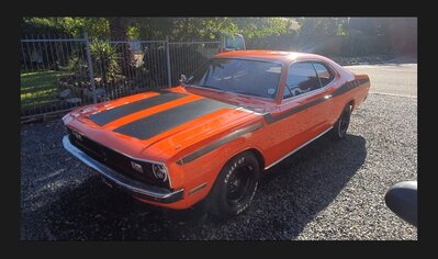

This is my car @slantsixdan is 100% correct "He has a 1971 Chrysler Valiant Charger Sports Coupé, which is a '71 Demon with right-hand drive"
My diff ratio stock is 3.23
Altitude is 400ft above sea level
But to be honest I have only learned what I know in the last year , I don't know what Camshaft timing , initial , vacuum curve are in details , I have an idea but this is the first time I've tinkered with engines .
I did all these mods myself using Youtube and Uncle Tony's garage and a mate of mine whose been a great help as he has a Slant 6 powered Valiant and a V8 Polara .
So in a nut shell , I did all the mods listed above , Set the timing , set the carb with a vacuum gauge and run low octane unleaded fuel
(All that's available here in SA)
The car isn't snappy but instead feels lazy, I mean it goes but it feels like I'm missing something .
What I would like if possible is a step by step tune up guide for my setup ?

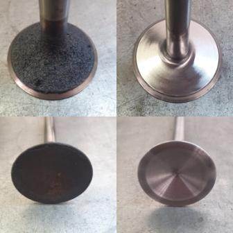

All I did was remove the little lip and clean up on the valves

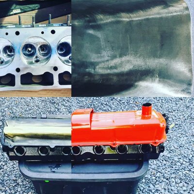

See the top right photo thats as far as I went with polishing the ports then I gasket matched .
