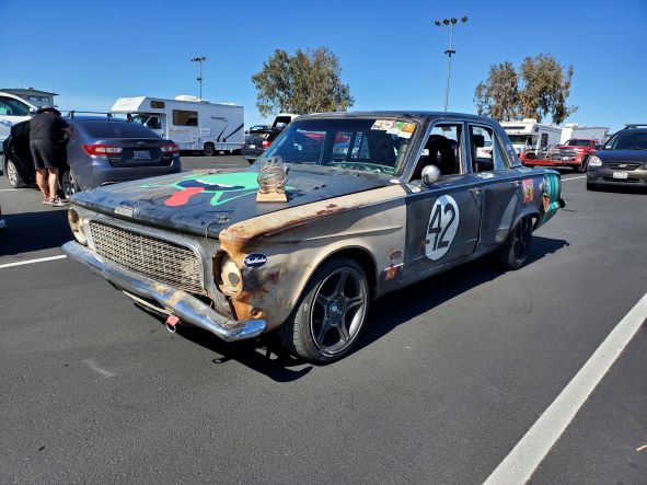

42

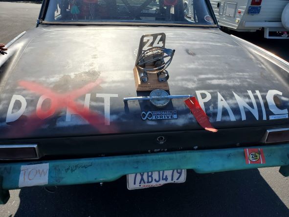

don't panic!

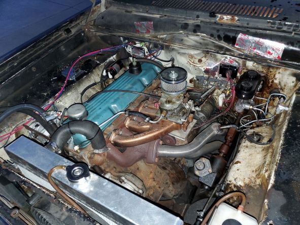

slant goodness.. I have a holley 390 to go on it before the next race.

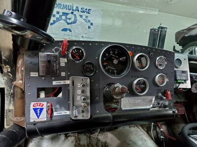

dash
