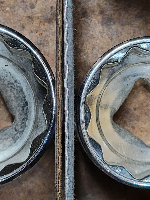

File comment: Here is an edge view of the FEL-PRO and Victor Reitz gaskets. I tried to show the FEL-PRO in an area that was not compressed by the manifolds.

Best thing would be to take the exhaust manifold (and maybe intake too) to the machine shop and have them mill/sand it flat all the way across. Doubling gaskets will help, but they will eventually blow out if the manifold(s) is/are not straight (planar).

Not Recommended. Finally did get remflex, but time had run out. Measured gap cut fel-pro spare gasket up, glued one small section to exhaust port with big gap. One other port smaller gap, found some thin card board to match the gap, cut to fit exhaust ports glued to port. Glue is for holding while assembling not for sealing. That was three years ago still holding. Remflex still on shelf will use it next time.
