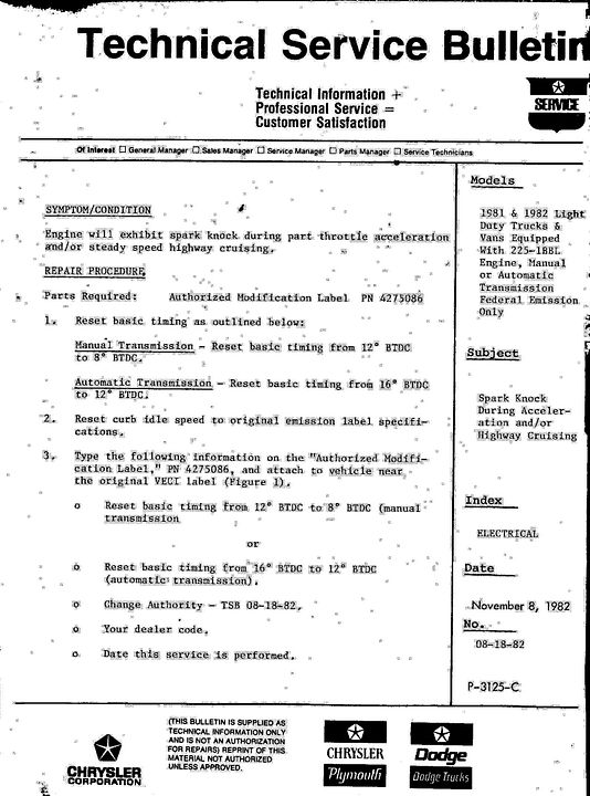

I have a 1982 dodge d-150 slant 6. What ignition system do you have perhaps lean burn, there was service bulletin about this issue. Will check my library Memory may be bad.

Hope you can this read .both same bulletin. scanner not working to good
