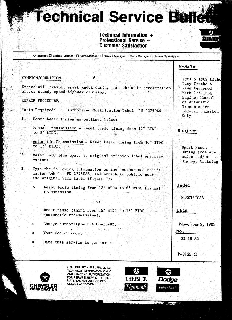

| Author: | matv91 [ Sun Oct 16, 2022 5:09 am ] |
| Post subject: | Re: Thermostat |
I have a 1982 dodge d-150 slant 6. What ignition system do you have perhaps lean burn, there was service bulletin about this issue. Will check my library Memory may be bad. |

Hope you can this read .both same bulletin. scanner not working to good |
