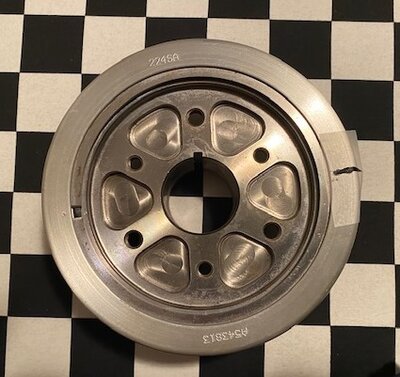

I have one of the Romac dampers, # 224SA. It has the steel hub and aluminum outer ring.
The depth of the front is about 0.44 inches. The black mark is where the zero mark is for timing.

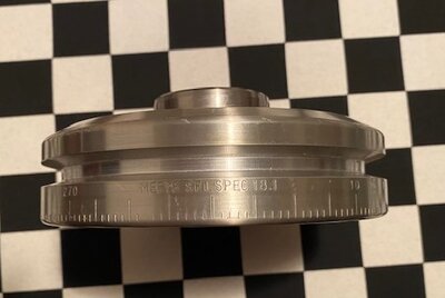

The overall thickness is about 1.6 inches, the belt groove starts about 0.6 inches from the front and is about 0.4 inches wide
The overall height is about 2.3 inches.

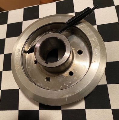

The depth of the back side of the damper is about 0.86 inches. The diameter of the inset part (front and back) is about 4.5 inches.
I hope this helps with your decision.

Matt, thanks for the photos.
From those it appears that an additional pully will not bolt to the Romac damper and maintain the OE belt spacing.
I am seeing additional thickness on the Romac damper from the edge of the V grove to the rear and front outer edge of the Romac damper.

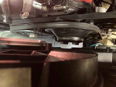

I have posted photos showing how closely the V groves are spaced on a stock style damper.
