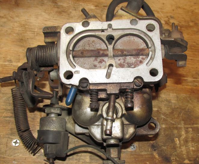

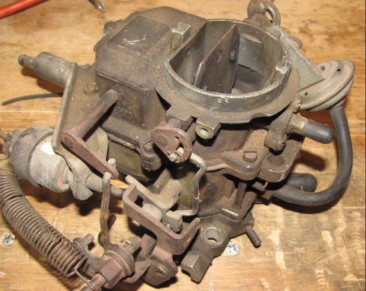

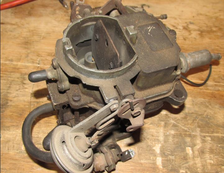

I have a Carter 2 Barrel here but no tag.
It's Mopar for sure, looks like emission era for sure with lots of do-dads on it.
Can anyone ID it from these pictures?
I am going to sell it after I find out what the application. Thanks

That is passenger side of carb at throttle plate. Does it look like that. Egr vacuum full throttle dump valve.
PostPosted: Sat Dec 10, 2022 7:48 am
Posts: 2717
Yes, looks just like that.

Ok good, went over carter stuff, Carbs that had egr dump valve and idle solenoid were only 2 1977 california emissions 318 auto carb number 8096s, and 1977 federal high altitude 318 auto carb number 8126. There were drivability bulletins and parts kits, step -up springs meterng rods venturi screws and new carb tag , for both carbs.This carb may have got up date unkown. Bulletin was for tip in sag a longer step up spring was what really needed.
PostPosted: Sat Dec 10, 2022 9:14 am
Posts: 1603
What is the green arrow pointing at. And a picture down venturi will help. The value in this carb may be it parts. Idle solenoid and brackets and throttle shaft. And that dump valve bracket is perfect for full throttle switch.

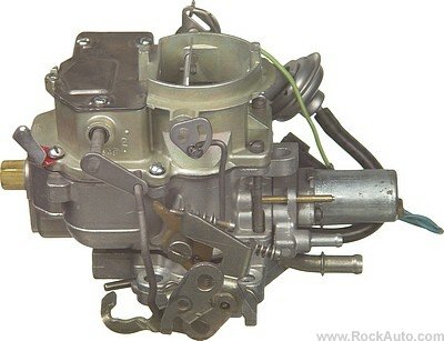

I think it's newer than 77 with the what I think is the mixture control solenoid (what green arrow is pointing out)
PostPosted: Sat Dec 10, 2022 5:33 pm
Posts: 25041
The mixture control solenoid on feedback ('81-'84) BBDs was on the other (rear) end of the carburetor, as shown here. That green-arrow-pointed thing appears to be a fuel filter threaded into the carburetor's inlet. Not a factory-type filter arrangement, but such filters were never difficult to get hold of.
