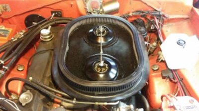

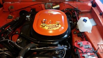

There was a recent post with 2 X 2 Weber conversion.
Also many interesting air cleaner set ups.
This is my favorite.
 Post subject: Re: Offy 2x1
PostPosted: Mon Dec 26, 2022 1:53 pm
Posts: 14854
The pads on the intake are large enough to drill the BBD pattern, then mill out the center. Hint-make sure to drill the bolt holes on the same angle as the pads. They do not go straight in when the intake is laying flat.
Barry Harrison used 2 BBD's for a long time. He was pretty happy with them.
