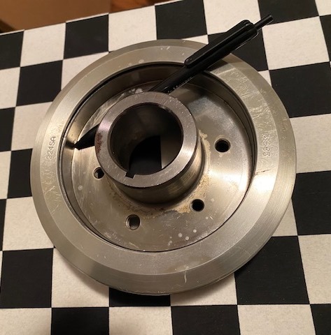

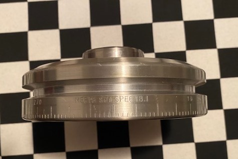

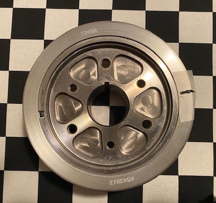

I have one of the Romac dampers, # 224SA. It has the steel hub and aluminum outer ring.
The depth of the front is about 0.44 inches. The black mark is where the zero mark is for timing.
The overall thickness is about 1.6 inches, the belt groove starts about 0.6 inches from the front and is about 0.4 inches wide
The overall height is about 2.3 inches.
The depth of the back side of the damper is about 0.86 inches. The diameter of the inset part (front and back) is about 4.5 inches.
I hope this helps with your decision.
