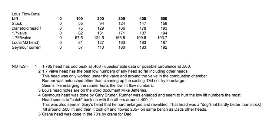

Here is some of what I found.
I think these are Doug's plots.

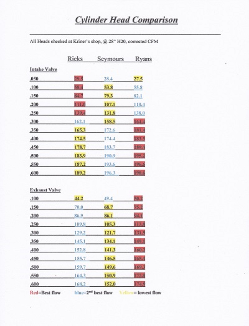

Here is our 3 tested on the same machine on the same cylinder at 28"
Ryan's had been professionally done with 7mm valves. Mine was one of the last ones Mike did. Seymour's was the one on the car when Ryan got it from him.

Rick, notice that Mikes head had the best intake flow of the three heads at the lower valve lifts.
I remember Mike saying that he was willing to give up flow at the largest valve openings to get more flow across the total intake duration. It’s what is called ‘area under the curve’. Remember the valve only sees the max lift once, it sees the other lift openings twice, once on the way open and once on the way closed.
The way the numbers look on the MJ head I bet those are 30 degree intake seats.

Yes my head does have the 30 degree intake valve

I am 99% Ryan's new engine used the same cam as was in the car before. Bottom end was .085 over just like my engine. I think the compression ration is 13.4 instead of whatever Seymour was running. But the car went from a best on 11.40's to and 11.00 in the quarter. That is a lot when you are going that fast already.

Respectable numbers for sure Rick...!
