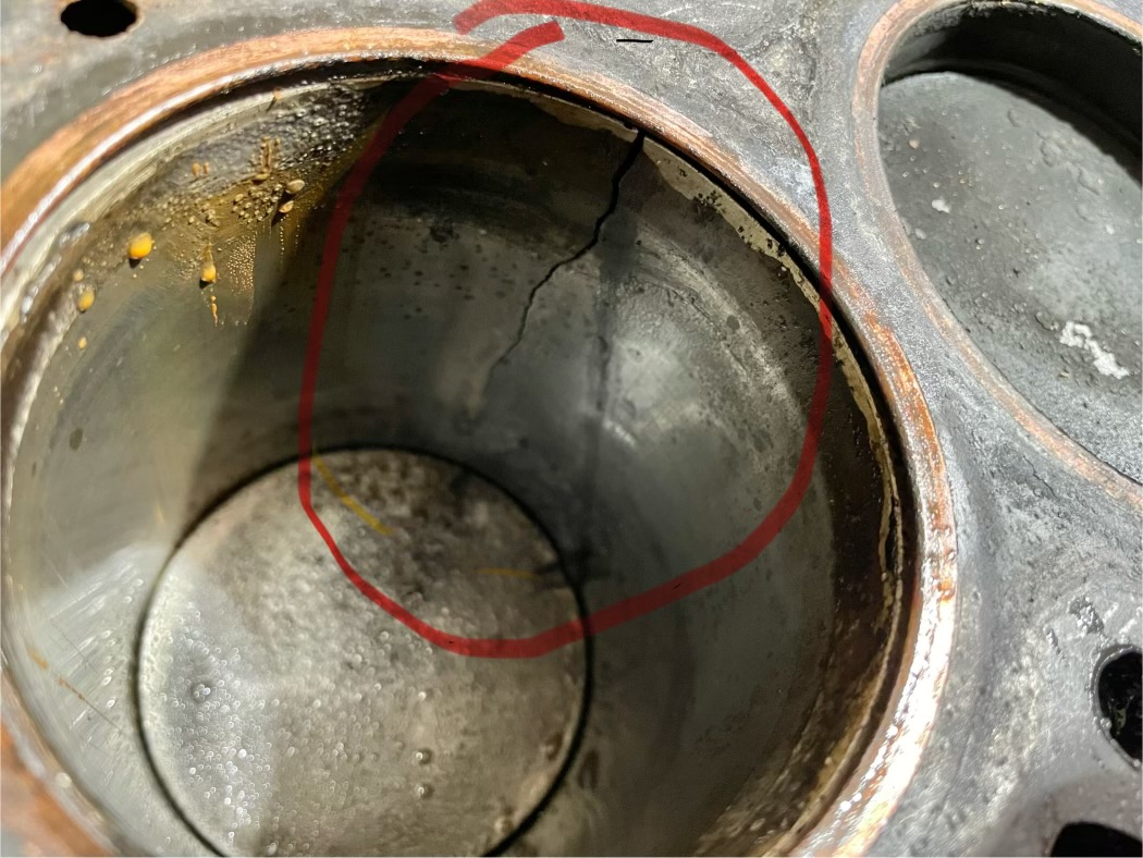

Hi guys , thanks for your responses. After pulling the head off i found that cylinder 5 was cracked. is there any way to fix this or is my block a bin job? :cry:
Can you post a picture of the crack?
Is it in the steel sleeve or the aluminum column that supports the cylinder?
If the crack is in the steel sleeve, I would think that could be repaired.
Don't give up yet!
PostPosted: Sat Jan 06, 2024 9:57 am
Posts: 17592
My guess is that if you find just the right machinist, and pay them well, they could put a cylinder sleeve in there to fix it.

Hey I have uploaded a pic of no5 cylinder the crack is the whole way through.
