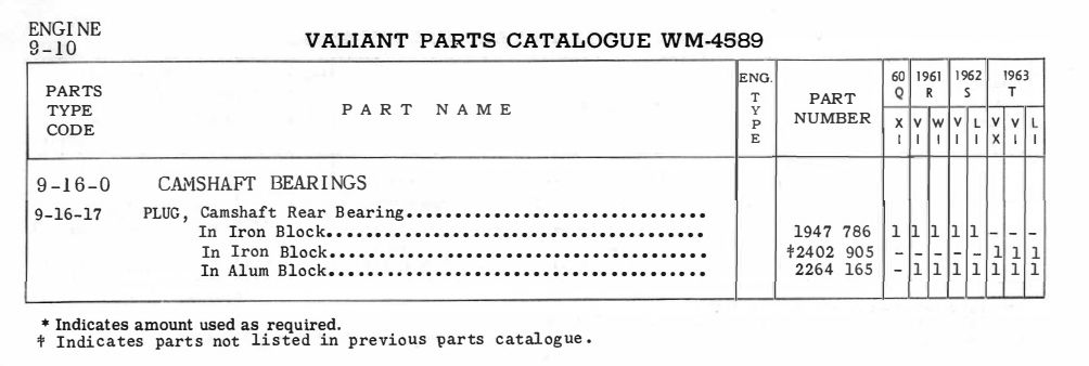

Looks like new plug ø for '63 on the iron blocks. That would make sense, because it corresponds to the new iron block casting numbers for '63—and that mysterious conrod oil hole about-face we were talking about.
PostPosted: Fri Dec 29, 2023 1:49 pm
Posts: 10360
Great, thanks for the Info.
Now I will know to never throw out those big cam plugs!
PostPosted: Fri Dec 29, 2023 2:56 pm
Posts: 25021
Why not just buy new? Last line item here in brass, for example, or fourth up from the bottom here in stainless.
PostPosted: Fri Dec 29, 2023 3:08 pm
Posts: 10360
Even Better!
Thank you sir!
