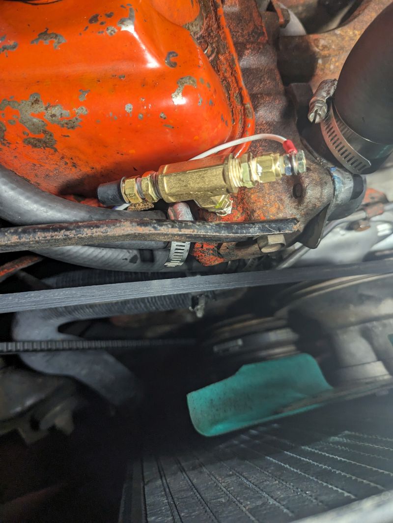

Recently, I bought a new set of electrical AutoMeter AutoGage type aftermarket gauges to add to my 66 Coronet with the /6. I want to be able to use both the stock in dash temperature gauge and the new below dash AutoMeter temperature gauge. Here is a picture of my installation with the two senders in a tee and then into the head. The stock in dash gauge sensor is on the left and the new AutoMeter sensor is on the right.
I tried to be careful and eliminate a big air pocket by putting coolant into the high side (right side) of the tee fitting just before putting the new sensor in.
Alas, so far neither gauge is getting warmer than about 125 degrees after two or three driving cycles. Will this tee set up ever work to give proper water temperatures or are the sensors just too far away from the head? The stock in dash gauge was working fine before this and I tried the new gauge sensor alone in the head port and it worked fine showing about 165 degrees after the thermostat opened.

Well, you are isolating the senders from the heat with that long tee and fittings, so that is probably why they are not heating up. The later Slant 6 heads had 2 (or even 3?) temp gauge/sender holes, if you wanted to get a different head. Or, you can get a 1.5" tee with a sender fitting for your upper rad hose, and that will read pretty close to the factory location (once the thermostat opens). The easy option is just run the aftermarket sender into the stock location and forget the factory gauge...

I did try a smaller (1/8" NPT) Tee without the reducer bushings you see here to get everything closer to the head BUT the two sensors are too long and run into each other inside the 1/8" Tee. So I had to try this 1/4" NPT Tee and the reducer bushings.

Thank you. When I had the tee installed I had made sure it was full of fluid as I inserted the second (higher) sensor. I drove it many trips, many cycles and neither sensor ever got above about 125 degrees. It seems the tee is just too far away from the flowing fluid and effectively only measures the head surface temp. I removed the tee. Now I'm going to locate the second sensor in the thermostat housing as suggested above. Then I will have a sensor on either side of the thermostat and will see how/when it opens. Just a fun little project since I need to replace the antifreeze anyway and I want to put in a new 180 thermostat at the same time.

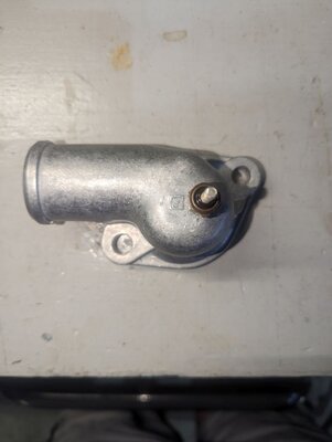

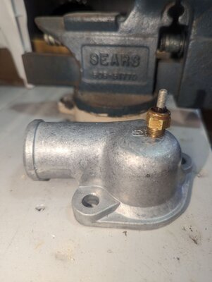

PostPosted: Sat Jan 20, 2024 10:25 am
Posts: 59
Location: Murrells Inlet, SC
Car Model: Dodge Coronet 440
I drilled and tapped the new thermostat housing I got from O'Reilly. Now I'm ready to switch it out for the current housing when I change the coolant and thermostat. Thanks for the suggestion! In the pictures is the stock temperature gauge sensor. I will move it back to the head and put my new AutoMeter gauge sensor into this new housing.

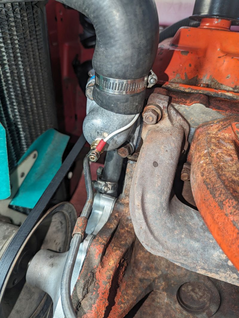

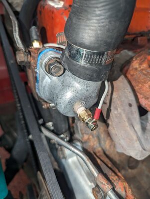

PostPosted: Sat Mar 30, 2024 10:03 am
Posts: 59
I finally got done with this job. I was waiting for a non-busy day with nice weather to work outside. See the pics. New thermostat housing with aftermarket temp gauge installed. I also switched out the thermostat 180 for the 160 that was there and replaced the coolant. Both gauges work fine, one on either side of the thermostat. Thanks all for the suggestions.
