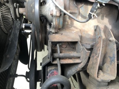

thanks but i have the service manual for years still not good enough don't show where the pump mounts too i have after market ac in my car is it mounted in the same spot

There is only one spot the power steering pump bracketry mounts- those holes on the driver's side of the block. If one or more of those holes are being used by the aftermarket AC brackets, you may need to change the AC brackets to install power steering. The factory AC bracket was separate from the power steering pump brackets, so you may be able to find an AC bracket from a different vehicle and use that instead of your current brackets.
I am attaching a picture of the power steering pump mounting on my 1976 Dodge D100. This bracket looks a little different than most passenger car brackets and other truck or van brackets I have seen, but it is factory and it works.
