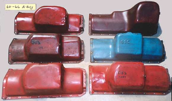

Looking for a center sump oil pan for my 1963 Dodge d-100

Like the left side ones of attached photo.
File comment: Like left side ones

Will the center sump fit your D100? I thought those trucks needed the rear sump...(?)

My D100 slant six has a rear sump oil pan. A center-sump would hit the straight axle.

Maybe 63 is different than 71 truck?
I have a center sump (~ 68 Dart) I could let go. Like the middle left one in the pic.

I am changing to a mustang II front end, that is why I need the center sump. The original is a front sump, the kit instructions say I will need a center sump but gave no part numbers for one

I had a 64 /6 out of a truck. It actually had a front sump, first Dodge anything I've ever seen with a front sump.
I had a guy from south Dakota trade me even up for a car center sump pan and pickup which went back onto the engine that originally had the front sump / and then I sold that engine with the pan that I had gotten in return...
