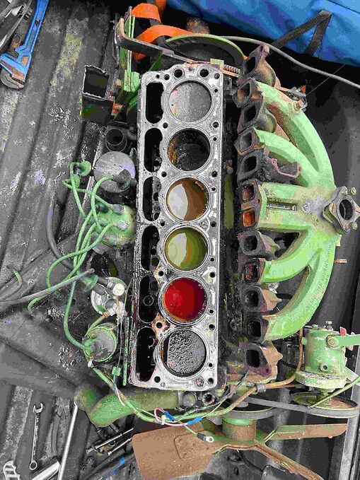

This is what the combustion chambers look like with the head off. All 3 cylinders with liquid are seized, they all have water and some coolant. I poured some ATF down the intake when I got the engine to try to help with freeing it up, which is the red fluid in the #2 cylinder. Pistons #1, #5, and #6 all came out pretty easily, I'm soaking the others in ATF, Diesel, and PB blaster and am going to try removing them tomorrow.
