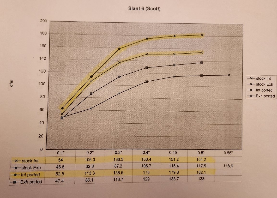

This is a flow chart made of the slant six head that one of my racing buddies had done some work on. I believe it is a drool tube style head and he had set it up for street use, not all out performance. These figures were taken at 28" and was done at a machine shop in Newport News Virginia.
It's a little difficult to tell in the picture, but from top to bottom you have Ported intake, stock intake, ported exhaust, then stock exhaust at the bottom.
