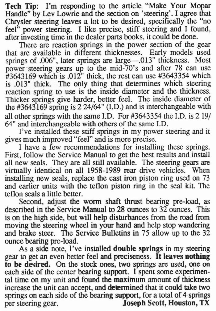

While we're at it: do this; if the steering gearbox adjustment(s) is/are loose, it'll aggravate the wandery/no-centre feeling.

Late-late last night, I recalled enough of this to go finding it today, in an old issue of Slant-6 News.

Dan--The tech tip is great info. I am considering have a core power steering unit rebuilt by these guys....https://www.powerbrakex-change.com//
They are local for me and while I've never had work done here...I did visit the shop once and was impressed by the knowledge of the owners and left with a good impression. This is the type of shop that seems to be run by folks that care about doing the work correctly. Pricing seems to be more reasonable too--with no shipping costs.
I would need to speak with them and see if they are willing to do the upgrades listed in the info Dan provided in order to build a better unit.
