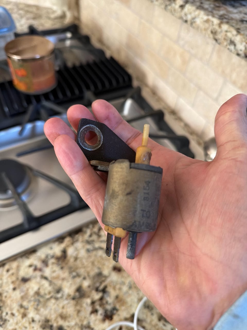

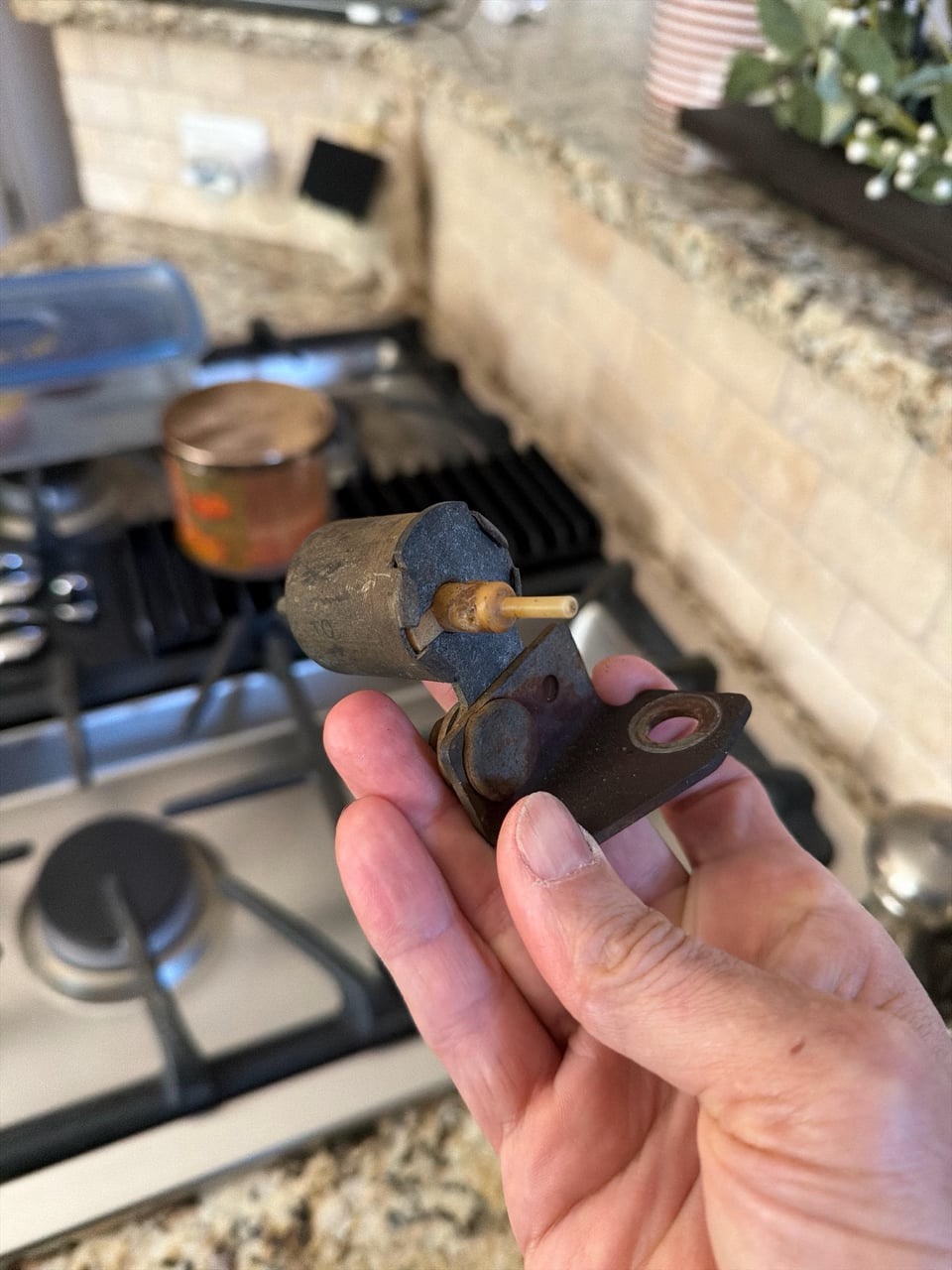

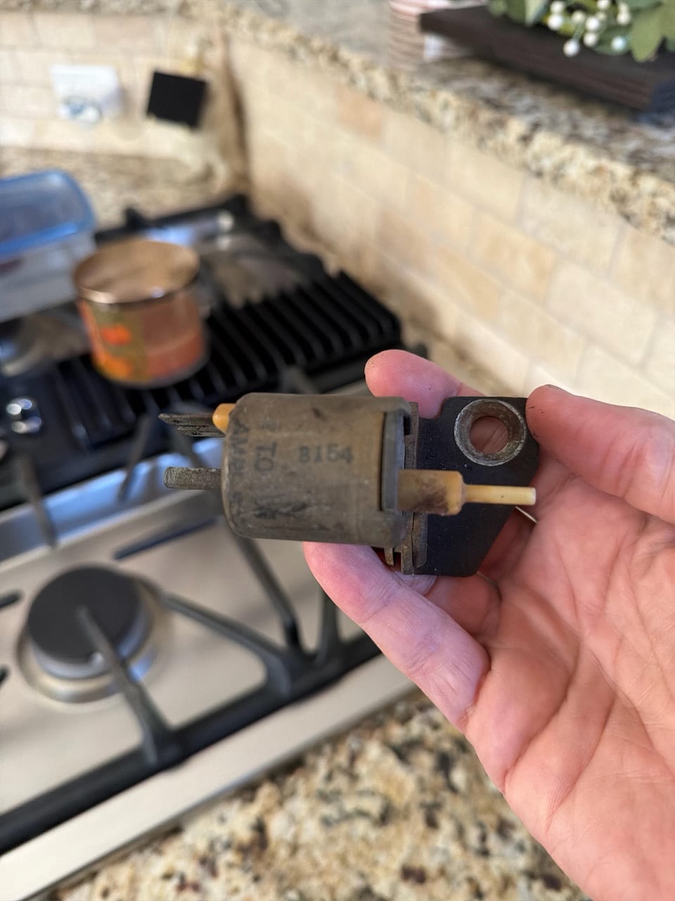

This was bolted to the cylinder head completely disconnected. I don’t know what it is, the engine runs fine without it, but I would like to know what it is.

That is part of the emissions / Vacuum System from a ~1979 vehicle, and possibly other years. I am not sure if it is slant 6 specific or not. I just tossed one in the can from a 1979 Volare' Duster that I am parting out.
I can get a specific on the exact name of the part for you later, as I have 2 1979 F body cars stored here at the house this winter.

It is a vacuum Solenoid.
There is an electrical connection to it that turns on and off the vacuum signal from the carb to some of the other components it is interconnected to. I am not sure of the other specific responsibilities of the part.
It essentially is an electric valve between carb vacuum and the vacuum amplifier.

Vacuum cutoff solenoids like this were used (in various years and applications) to:
• enable/disable vacuum spark advance (first application was '71 California cars – coupled with a 3rd-gear switch on the shift linkage for manual transmissions or to an over-30 speed sensor for automatic transmissions)
• enable/disable EGR (coupled to coolant temperature sensors to preserve at least some pretense at driveability when the engine was cold)
• probably do other things, too

Now that I know its function I did find it. Looks like Chevrolet used the same part.

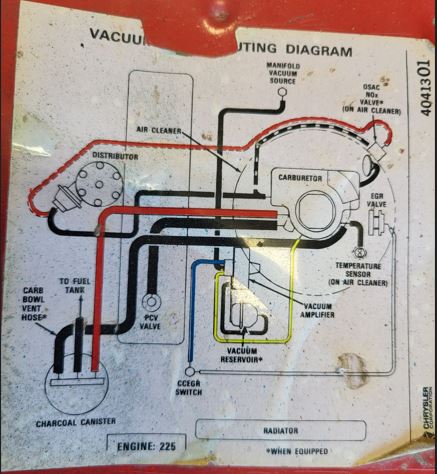

Is there an electrical connection?
Could it be the vacuum reservoir?
Here is my 76 emission decal.

It’s a TCS
Here’s the identical part
https://www.corvettecentral.com/70-spar ... 6cE80OU6W-
