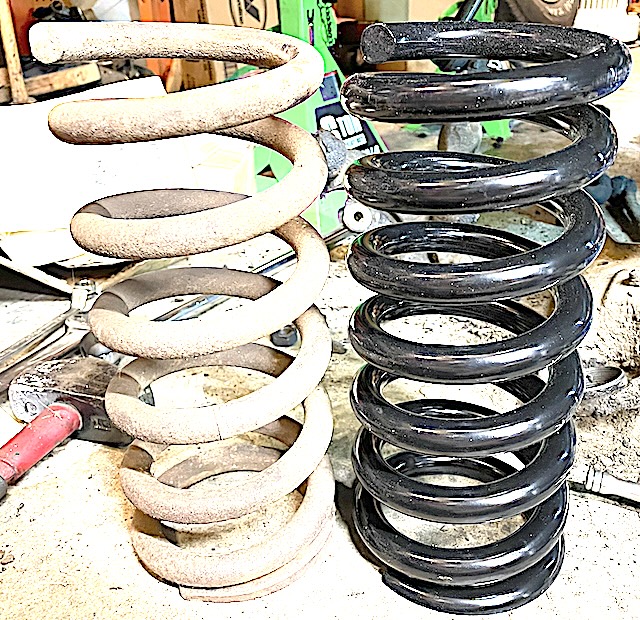

Is it normal for a completely new front suspension, including new coils to sit high until it settles a bit?
I have the front end of my truck completely rebuilt, including new coil springs. I noted that the gap between the top of the tires and the fender is bigger than it used to be. The truck is still sitting on ramps in the front and jack stands in the back, so I can;t get a good picture or really good look, but it sure does seem that the front is noticeably higher than it was before.
Then again, maybe the old rear springs are worn out and the old front springs were, too, so the new front springs just reveal a problem that used to be hidden by worn out coil springs.
However, the new coil springs have more but thinner coils than the old springs:
The new springs (on the right) are the same resting height as the old springs, but the spring is slightly thinner and there is one more loop than the old springs.
Should I relax and give the new suspension time to settle? I added coil spring isolators on top of the coils, if that makes a difference.

More and thinner coils should be a softer coil I would think. I would give it a bit to settle in.

I replaced many coil springs over my years of turning wrenches. It was common for cars that had new fronts to sit nose high for a bit. We did have customers that couldn't stand it even for a while that would then ask for new rears.
And if you went with cargo coils (variable rate) springs they wouldn't quite sit as high as if we had put stock type replacement coils in (not saying original equipment as aftermarket offered both for most cars and trucks common then)
But they wouldn't squat quite as much when loaded as they would with constant rate springs either and usually ride better with the variable rate.
And you can't judge how a vehicle will sit by comparing "free length" of new vs old springs while springs are sitting next to each other on the floor. Sometimes they use slightly different gauge wire to make the springs than original. Then consider the old ones are wore out so will take less to compress than new ones would.
8 do know that shortly after putting a 318 where a /6 used to be in my 79 D100 I had a front spring bust on me... That truck carries a /6 for 12 years before I made the swap. Now with a 318 putting more pressure against the old springs on every dip and bump brought out the fatigue the springs already had.
And consider the parts catalog shows the same replacement springs for the same truck whether a /6 or a 318 when new they don't have any fatigue yet...

I think, if the static hight is the sane as the old spring, the smaller dia of the coil will give a softer ride (less lb/in of deflection) but the extra coil will give a total load the same as the old spring.

I think that is backward Charlie. The longer coil spring (or a leaf a leaf spring for that matter) has more leverage and will move easier. ie be softer. If you were to stretch the spring out it takes less force to move it if it was 3 ft long as compared to one that is 2 ft long, with the same size spring diameter, due to the leverage. That's my story and I'm stickin to it. I think. :D

OK, thanks all. I will let it be and see if the front end settles down. Then compare the back end and see if I need to look into lowering the front or raising the rear.
