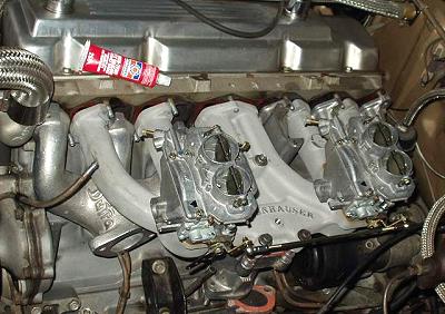

To that end, we have a Proline Fuel Dual Weber set-up that Chris Jones wants us to test so on the car it goes.

Here is the Finished Installation
The system started right up and runs sweet.
Now we get to do some tuning and testing.

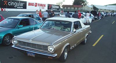

I was driving my 65 Dart Convert around Wednesday afternoon and found myself near Sears Point (Infinion) raceway.
Wednesday is bracket race night at this track so I decide to stop in to make a couple of passes, just to see what the old Dart with the newly installed Proline Fuel / D. Duals set-up would do. Basically a "shake-out" session for the up-coming Las Vegas race.

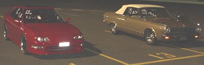

Anyway, the Tech Inspector checks out the car and sees that it has a Slant Six so he sticks me in the "Sport Street" bracket and tells me to use lanes 7 & 8.

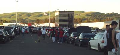

I get to the staging lanes and find a big crowd of Import Cars! There must be over 100 of them. :roll:
I get in a time run and then win the first round of eliminations so I decide to stick with racing until I get eliminated.
The sun goes down and I win a couple of more rounds. Funny thing is that I'm on the brakes at the finish line on every run so far. I'm starting to get "dirty looks" from the rice boys.
Well, sure enough, 7 rounds later, I'm in the final. :grin: Actually won the Bye Run in the semi finals on a coin flip, I never even got out of my car, I just called "tails", it was tails.
In the final race, the other guy went "redlight", it must have been that red car he was driving! (Truth is that he just could not wait at the starting light for the 6 seconds it took for his side of the tree to come down)
I just cruised the car down the track and thru the finish line after my win light came-on. 8)

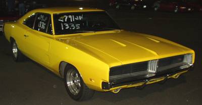

So...Mopar did good at Sears Point Raceway Wednesday night. In fact, runner-up in "Jackpot" was this Charger.

Truth is that the car is still slow off the line, the best pass was a 19.21 @ 70 mph.
The main problem is the 2.94 rear end gearing and 1800 stall converter, made for a real lazy 60 ft time. (2.7xx)
I also think the carbs are a bit on the rich side so I will lean them down a bit. This will be important at the 2000 ft. Las Vegas track.
I will take a set of 4.56 gears with me to Vegas, with a little 'tweaking' and some lower gears I hope I can get the car into the low 18s. (It is a stock aluminum block engine so I never expected it to be super fast, even with more carb and exhaust.)
One thing for sure is that the Proline Fuel Dual Weber set-up does work well right out of the box, even on a stock SL6.
