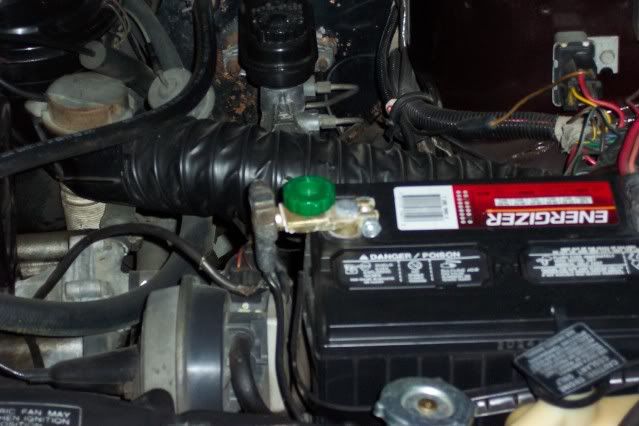

Goes with-out saying but I will say it... be sure to disconnect the battery prior to starting any under-dash work.
This would be a great time to install a green knob battery disconnect switch. Wal-Mart has them for about 7 bucks. These things make it real easy to kill the electrical system for storage, and should something start to smoke. One flick of the wrist, and the current is off in less time than you could call the fire department on speed dial.
This happens to be my LeBaron's battery shut-off:

Thanks for the suggestions....I'll definitely add that cut-off switch.
I'll post an update after I get the radio and rheostat working.
