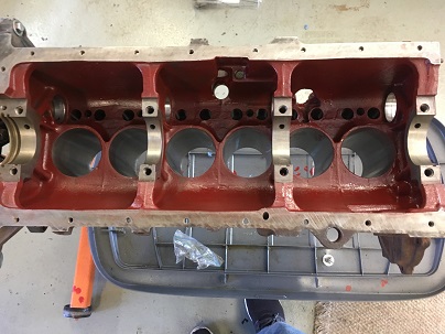

inside: Gyptal 1201 Red Enamel
outside: IH Engine Red
concerning the casting defect shown in the second photo......
Chrysler had a grey iron foundry in Indy through the early 2000's.
Called the Tibbs Avenue Foundry, had previously been The American Foundry.
Its all gone now.....
They implemented a molding upgrade in the mid 80's called Impact Molding.
One disadvantage of Impact molding was it produced very hard molds. A hard mold will have
lamination that will break free and float when shocked by the hot metal inflow.
I believe the photo is a mold scab. If the mold scab had floated to a bearing bridge or head face area it would have scrapped this particular casting. As it is, it resides in a non critical stress area, does not leak,,,for me is an interesting curosity.
Is this just to help drain back? Help me remember. :D
PostPosted: Sat Apr 28, 2018 6:42 am
Posts: 3857
Help me remember
well,,, I am more than a bit of a neat-nick and I like the way it looks.
Are there benefits beyond the aesthetic?
My thought process goes like this:
* Is there windage drag in the crankcase when the motor is at speed?
Yes. A Yes is good.
** Would smoothing the crankcase walls have the potential to reduce the effect of the windage drag at the crankcase walls?
Yes. A Yes is good.
*** Does the Red Gyplal paint smooth the interior crankcase walls?
Yes. A Yes is good.
**** Are there potential downsides to the Red Gyptal Paint?
Yes. A Yes is not good, additional detail needed.
I reviewed many internet discussion logs concerning Red Gyptal paint use inside of crankcase's.
There are users and non users of Red Gyptal paint in these discussions. Non users out number users by a wide margin
The down side mentioned most often is the possibility of the Red Gyptal paint breaking free and contaminating the oil, clogging the oil pick up.
That the Red Gyptal paint can break free is mentioned only by the non users. I have found no occurrence where an actual user of Red Gyptal paint reported that the coating caused any downside issues. All upside benefits mentioned by all the users are conjecture as I have done in the initial three bullet points.
and that is my story and I am sticking to it :roll:

Years ago Hotrod magazine suggested Rustoleum white enamel. I tried, it worked, but I doubt if it made any difference.
PostPosted: Sun Apr 29, 2018 11:13 pm
Posts: 14833
My take? I seriously doubt glyptal will plug up the pickup. I would also bet the difference is too small to measure. What would intrigue me would be if it speeds oil drainback maybe you could reduce windage by running less oil in the pan without running it out.
Bottom line is if it makes you happy to do it, do it. :D

I've used Rust-Oleum rusty metal primer for this same purpose.

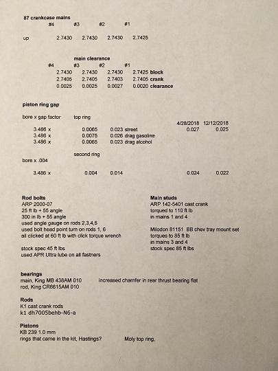

Putting the motor together, it is a last year 1987 cast crank slant.
some of the components are:
KB 239 one mm oversized pistons
K1 cast crank rods
King AM rod and main bearings
I-J up and down crank scraper
Mopar Performance windage tray
ARP studs in mains 1 & 4
Milodon BB Chevy tray studs in mains 2 & 3, those tray mount studs are not a low cost item, but they allow for adjustment to get the tray and crank clearance right.
The cylinder head is at a shop owned by one of the engineers that I worked with back in days when we worked for that Chicago base truck manufacturer.
He was an engine air flow specialists then, and he has moved on to that big bore engine manufacturer located just south of Indy. He has a really nice Serdi Valve Seat
Machine, we will see how it all turns out.
