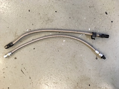

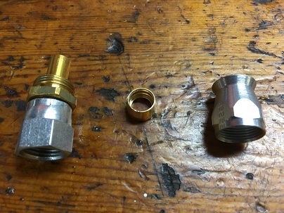

the plan for the next motor is for it to run on E85
the car has full return fuel line system with 3/8 stainless lines under the car. I have a couple of feet of flex lines at the tank and engine ends to make the connections easy and to control vibration to the hard lines.
So I am removing the existing rubber lined flex lines and swapping in PTFE lined flex lines.
The flex line material that is E85 approved with a PTFE inner liner takes a fitting with an internal ferrel.
it is still hand assembly, no special tools required. The PTFE hose is a slightly smaller outer diameter, because the PTFE inner liner is much thinner than the rubber liner in regular stainless wrapped flex hose.
File comment: fitting for PTFE hose
File comment: top hose is the standard flex hose, bottom hose is the hose with the PTFE liner

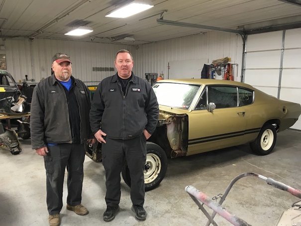

The morning of Christmas Eve day, and the 68 Barracuda went into the restoration shop for floor pans and frame work.
That is a nice Christmas present for me. :D
The shop is American Classic Restoration in Anderson IN
I interviewed and did a walk through of a couple of local restoration shops. I went with ACR as their shop is clean, organized,
they were willing to work with me on the timing and I had previously seen some of their work, good stuff.
Another plus was they do a lot of mopars, they currently have full restorations going on: a 57 Chrysler 300, a 68 Roadrunner and a tribute '70 Superbird.
Vlaid commented to me that the guy having the 57 Chrysler redone is going have over 8 grand just in chrome work.
Getting the 68 Barracuda in the shop today is about a week off what was planned by ACR back in late October, but that is still well within my planning time frame
of getting the car back to my garage in early Ferburary of 2019 so I can start my task of putting it back together and have it on the road by May.
I am currently working on rebuilding the steering column, after that I will put the cam in and build the cylinder head and finish up the motor.
File comment: On the left is John, he will be doing the metal - weld work.
On the right is Vlaid, the shop manager
